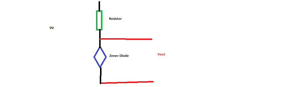

4.7 V zener diode - Unsure what is wrong????????

Forget about zener with 10KΩ input or R divider to high impedance uC input clamp diode to Vdd.

About driving the MCU input pin, the current of the clamping diode (as 1N4148, low capacitance) from the pin to MCU Vcc (its cathode at Vcc) will be about:
(9-5.5)/10= 0.35mA.
Even if most of this current passes in the MCU diode (in parallel internally), it won't affect the pin functioning.

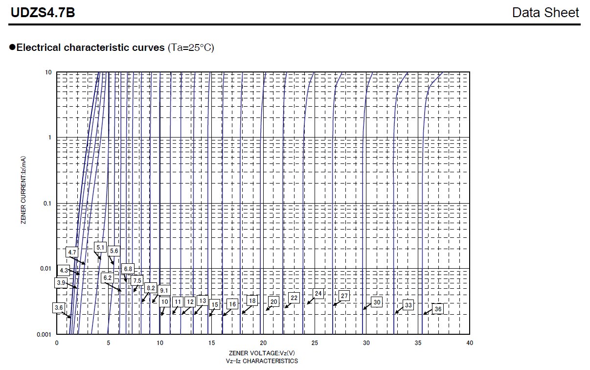

On the other hand you can use a zener diode instead (between pin and ground) but you need to choose its voltage as 5V6 (perhaps 6V2) to get about 4.5 V at the pin since the zener current is very small limited by R17 (for standard 400mW zeners, the typical current to get Vz is 5mA).

First I built the circuit presented by KerimF on a breadboard and it worked fine. After few days I had some free time , so I ended up fiddling around with my old circuit and randomly tried few resistor values (in the final voltage divider) and a particular set worked for me. It was liking hitting a jackpot. Using 2 resistor instead of the zener was your initial suggestion , wasn't it? :p
---------- Post added at 09:46 ---------- Previous post was at 09:35 ----------
My oscillator was working properly for a range of inductor values so I didn't change it. It was the "squaring" up of the sine wave that was creating problem.
