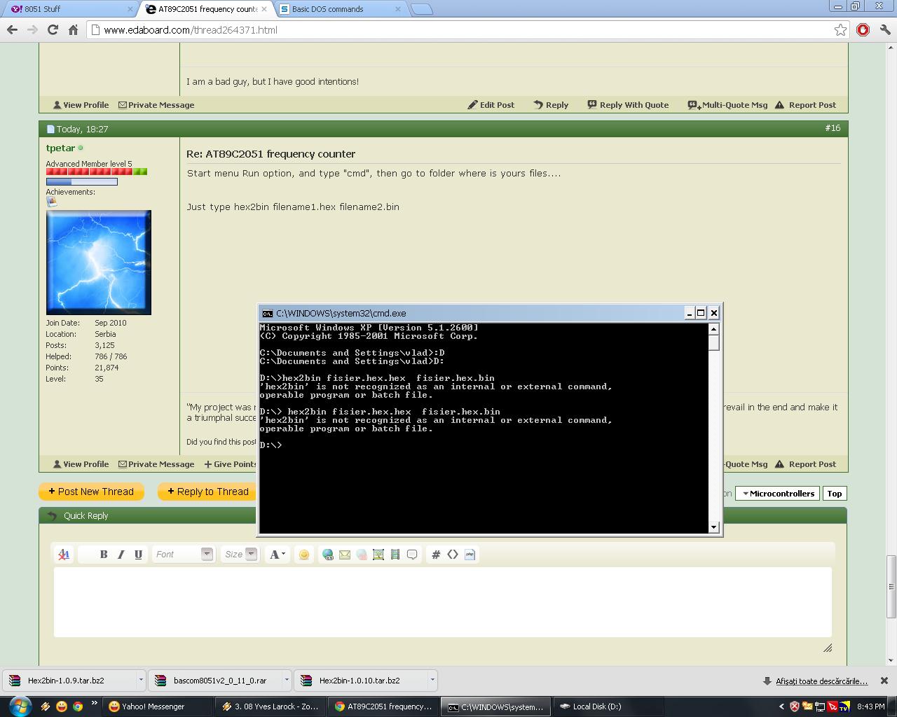

hey i download a hex o bin tool but i can make it binary because the dos windows dissaper verry fast

Start menu Run option, and type "cmd", then go to folder where is yours files....
Just type hex2bin filename1.hex filename2.bin
i have this error
i put he hex file in the local Disk D to make the comand easy but don`t work

Vlad my friend I see lack of DOS knowledge.
Attach HEX file in post, I will convert it for you, or you can do it just remove one .hex from first file and .hex from second file:
hex2bin fisier.hex fisier.bin

HEX2BIN is old tool and recognize only old DOS format 8.3 (8 characters for name and 3 for extension), and file is formated with extended format up to 255 characters "FreqCounter.hex".
to use long names in 8.3 format syntax is "freqco~1.hex".
HEX2BIN freqco~1.hex f.bin
Converted file is :
