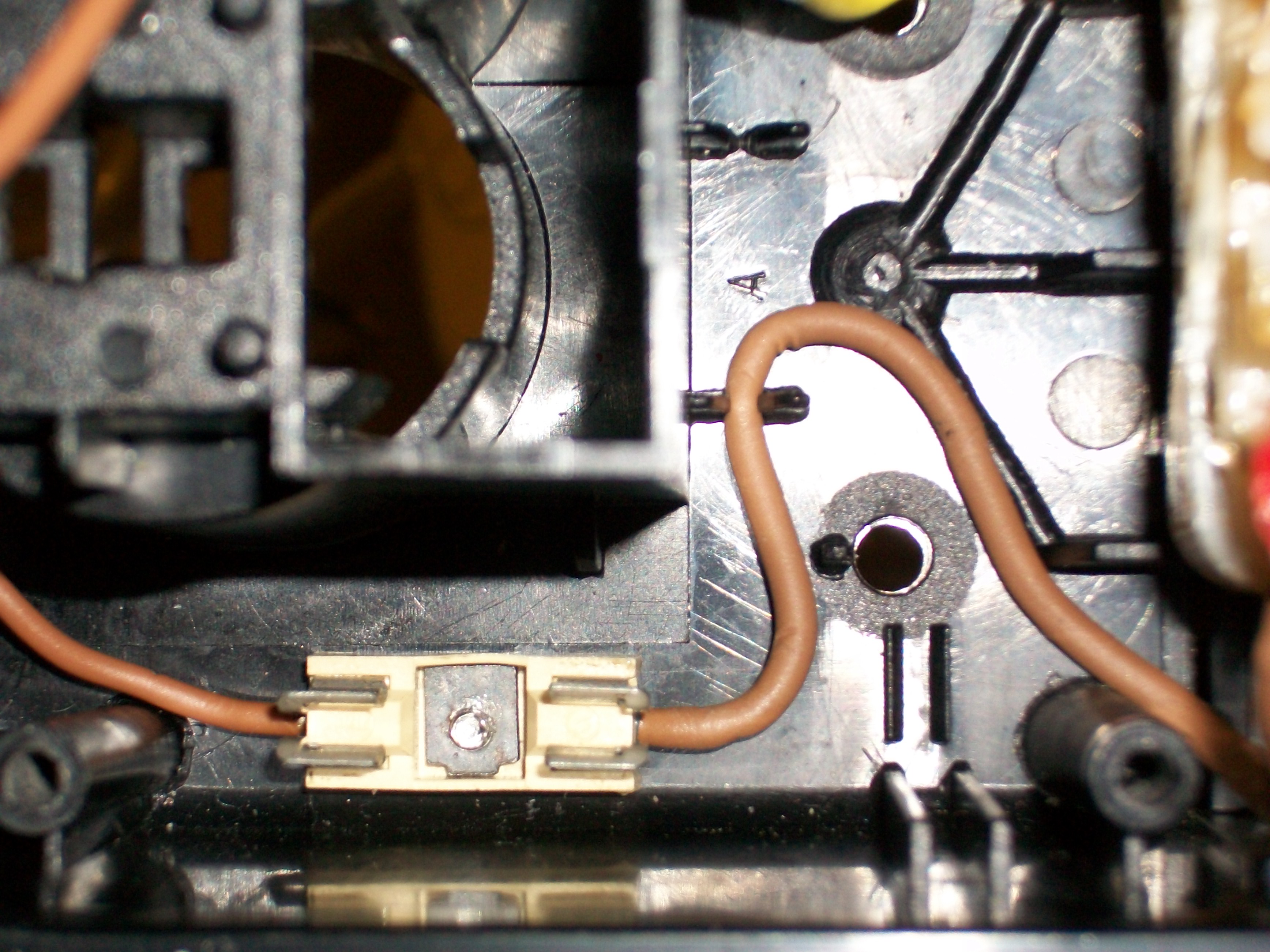

hi, well the new parts have arrived, the problem is now what do i use to connect them as i cannot solder the fuse holder to the secondary output wires. any ideas anyone?..
Use the hole in the fuse holder to mount it somewhere inside the plastic case, it doesn't really matter where as long as it doesn't touch anything else.
Unsolder 1 white 'AC' wire from the PCB and re-solder it back to one end of the fuse holder, use the little tag that sticks out from the end.
Using a new length of wire, solder one end to the other tag on the fuse holder and the other end of the wire to the 'AC' connection where the original white wire used to go on the PCB.
Finally, fit the fuse in the holder and fit the clear plastic guard over it.
Done!
Brian.
hi, thanks for the reply. I miss understood the soldering bit sorry, you ment dont solder directly to the fuse.. I got it now will give it ago, thanks for the info...

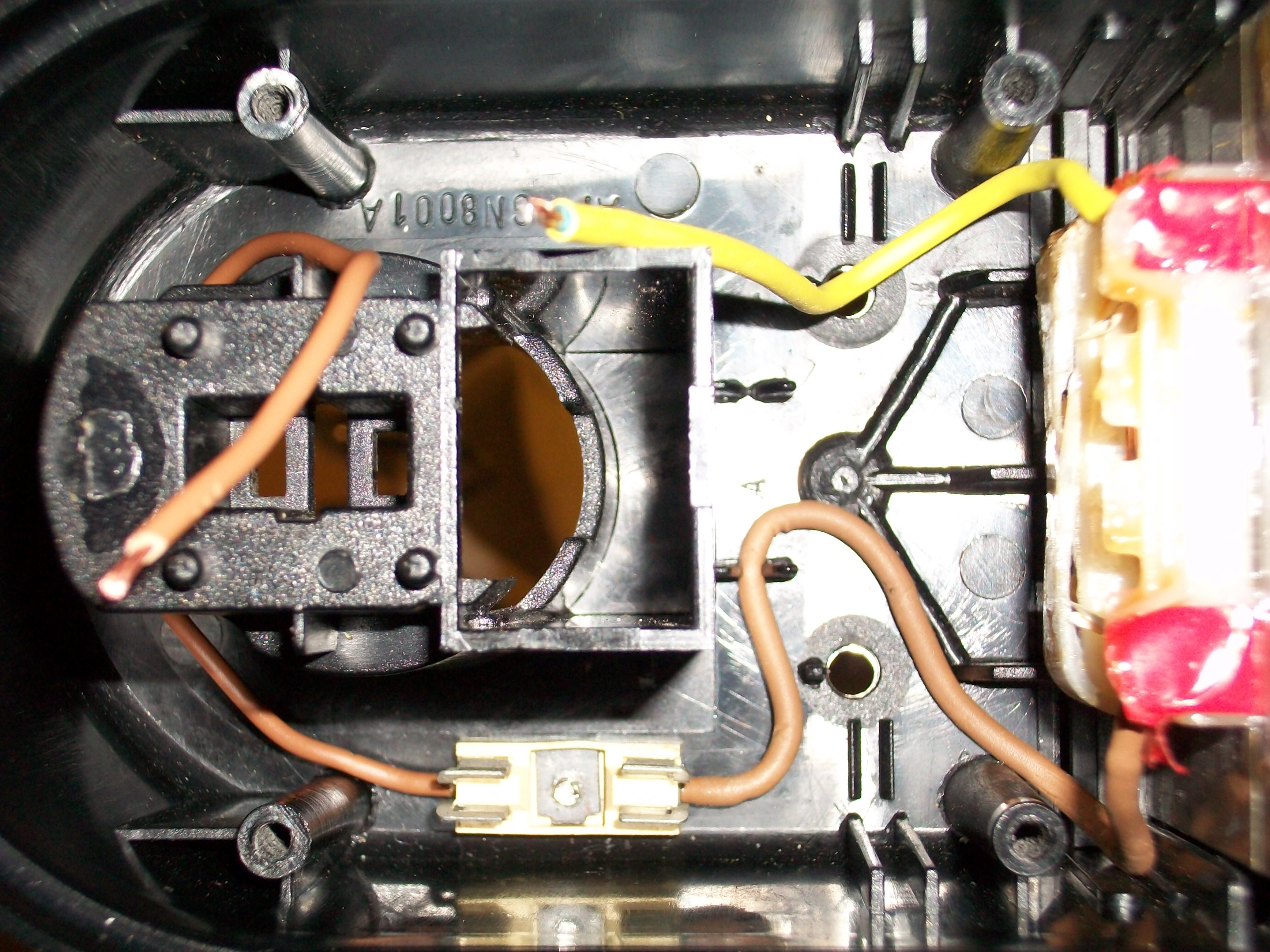

hi, well this is how i got on, soldered a brown wire from the transformer secondary, passed the brown wire under the pcb to the fuse spure, then took anothor brown wire from the other end of the spure back to the pcb AC input.. . I then soldered a yellow wire from the transformer secondary straight into the pcb AC input. I need for it to be checked over befor plugin the charger in. many thanks...
Looks very good!
Just check the fuse doesn't touch anything else when the small board is refitted - otherwise it's 100% Well done!
Brian.
hi, thanks for the reply. I have just switched the charger on with no problems, untill i insert the battery it blows the new fuse after about 5 seconds, any ideas....
hi all, right i have replaced the fuse and left the charger running for about 4 hours without any problems. I have done a test on the charger outputs a it reads 20.15Vdc. I also tested the battery and i get a reading of 12.73Vdc. Im trying to get my head around this, could it be when i insert the battery its drawring to much voltage or current from the transformer to the pcb to the battery, so it must be drawring to many amps for the 1.6amp fuse to blow, is that right?. so i think its down to a component on the pcb or the battery, or would it be the transformer itself? im just trying to get my head around this....:?
