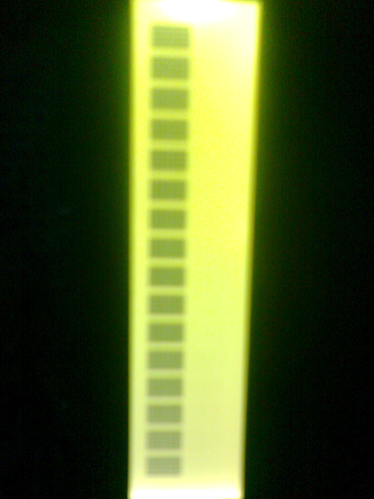

I didn't try with a potentiometer. I connected a 10 k resistor to the point 3 and grounded it's(10k) other end. I still got the same output.
Here's the picture of it.

From the photo, I guess your problem is improper initialization. If the hardware connections are okay and if you powered the LCD, it will show like this as in your photo. Nothing is wrong with the LCD. After a proper initialization only it will enter the working mode.

It's WORKING, I can tell from the photo.

As both Vinodstanur and I have indicated, the problem appears to be your LCD initialization sequence. Without the proper delays the LCD will not initialize and function.
Add the proper delays and command sequences to your code, then post the updated code so that it can be examined.
The link Vinodstanur provided has an excellent flowchart show the proper delays and command sequence.

And if you connect pin3 (contrast pin to ground it will work, you will see dark black blocks)..
Good Luck :)
