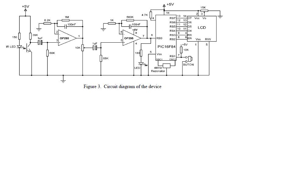

i am using an IR sensor to measure the blood flow in the finger, by placing the finger between the sensor and IR LED(transmitter). I need an IR sensor sensitive enough to detect the change in intensity of IR radiation caused by blood flow.
Please suggest which sensor can i use?
This is the circuit we have built.. so could you suggest how to add LDR sensor to it ? this is our circuit -
We require the sensor to detect the light with IR wavelength, will LDR solve this purpose ?
