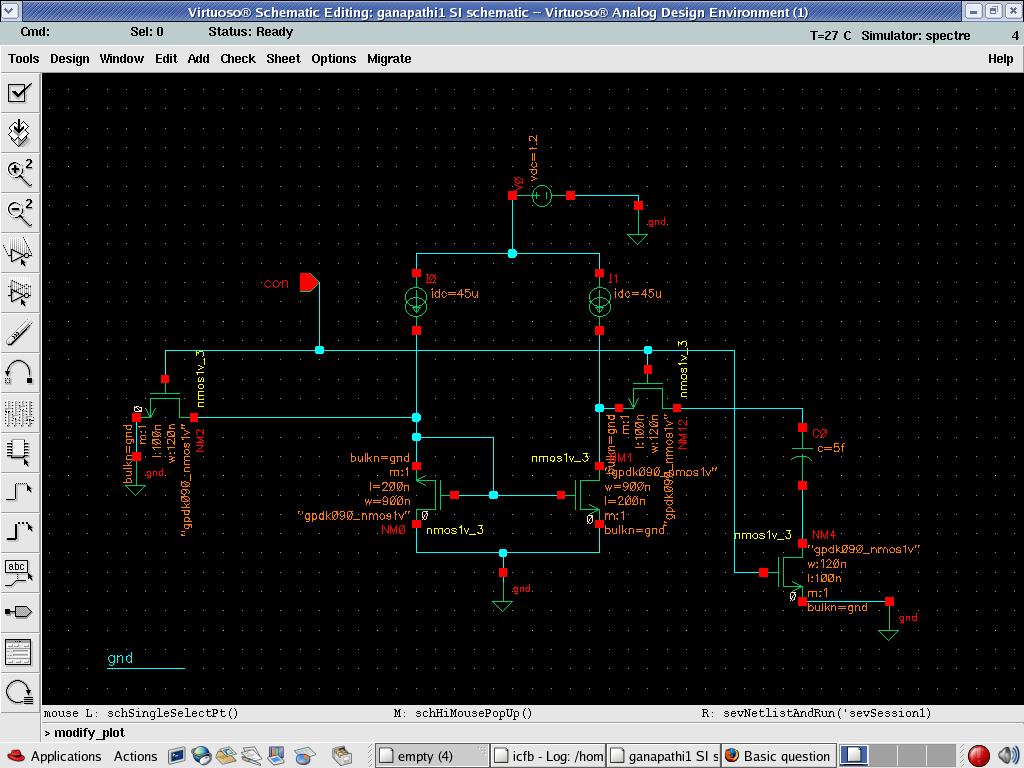

Coming to current issue I'm posting schematic and output of the circuit.Please help me in solving the problem.

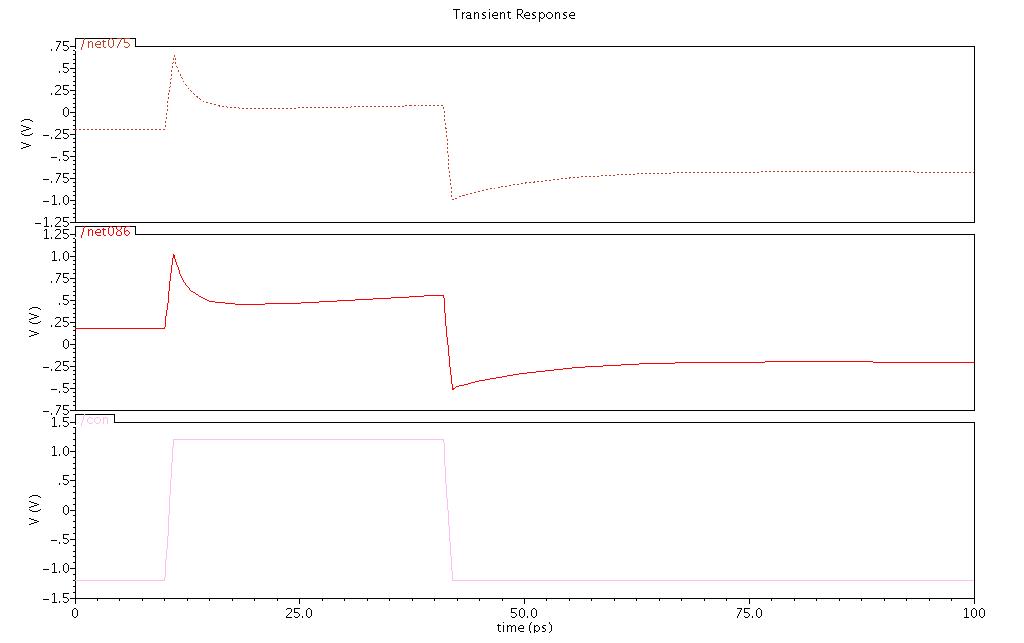

Can u plz explain me what is that happenning in my circuit

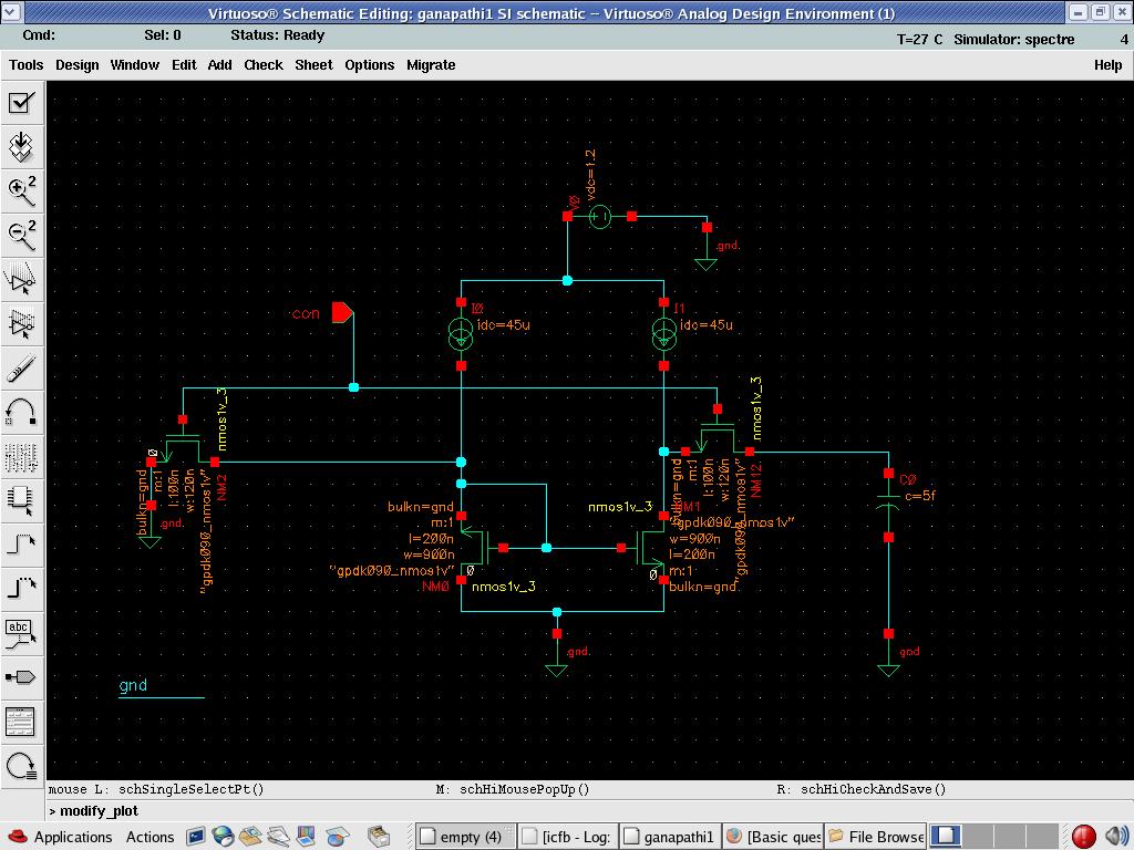

"net075" and "net085" are voltgaes at two terminals of the capacitor.I don't why votage at the terminals are rising eventhough there is no closed path for the terminals to get charged up ( "con" signal is turning of the transistors "NM12" and "NM4").
And if I removed "NM4" voltage at top of capacitor is stable.
Please help me,its urgent.Thanks in advance.
When NM4 is turned off, there is no way to keep the voltage at the cap bottom zero. This node will be easily coupled to other voltage by parasite capacitance.
If you want the voltage at the cap bottom to be zero always, it should be shorted to ground.

Whenever you have nodes of very high impedance in your circuit, small stray currents can result in large voltage variations. It's simply V=IZ.
What you are seeing are all the non-idealities faced by switched cap circuits, clock feedthrough, charge injection, leakage current, parasitic cap etc etc. Take a lesson from switch cap techniques, ie use dummy mos caps, use non-overlapping switching, maybe even control the slew of your control signal. And if that cap is going to float for too long, do not expect it to retain its charges indefinitely.
Added : Just saw your cap is only 5fF. That is on the same order, or maybe even an order lower than stray capacitances. What do you expect?
