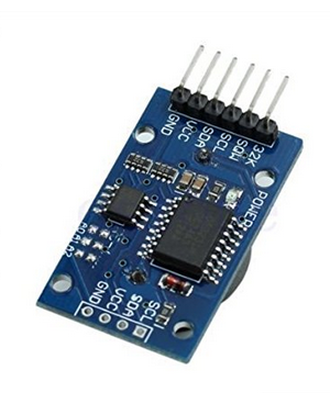

Hello Guys,
I am trying to connect DS3231 RTC to my PIC microcontroller 18f46k22. But my code is getting stuck at I2C1_Wr(DS3231_Write_addr) command. Any idea whats the issue.

What happens?
Error description?
Scope picture?
Klaus
Hello KlausST,
I am getting "Before 0xD0" message in my LCD display.
Show circuit. It might be missing 4.7k Pullup resistors on the I2C Bus.
This
I2C1_Init(10000);
should be
I2C1_Init(100000);
Hello Guys,
I did try with changing I2C1_Init(100000); but no luck. Also tried with Pull up resistance but still the same issue.
Below is the circuit diagram. Its working in proteus but not on real hardware.
Also I am using DS3231 module below is screen shot.
Regards,
Dev
Try use I2C SW driver. A made this one and it works perfect.
Hello Easyrider83,
I really appreciate you suggesting me to work through your soft driver.
But with all due respect I hope mikroC I2C library works fine as its working for others. Apart i did try with mikroC soft I2C library as well.
Do you any suggestion why my code is getting stuck at I2C1_Wr command and any way to fix it?
Regards,
Dev
I can provide further help if you zip and post the complete mikroC project files and Proteus file.
Edit:
Try configuring I2C pins as input pins by using TRISx register.
Just noticed that you are using I2C1_xxx functions but connecting I2C2 in the schematic. Please clarify.
You are using I2C2 in Proteus Circuit but using I2C1 in code. I don't know how it working in Proteus for you.
Hello Okada/Fvm,
Actually I was trying with I2C2 module as well, but the same results.
Okada I also tried with setting TRISC as input, still its getting stuck at I2C wr command.

After making some changes it started working for me. In mikroC PRO PIC project settings PIC18F46K22 was selected but in Proteus file PIC18F26K20 was used. I don't know whether your OSCCON setting was correct or not because I didn't check the datasheet. Proteus was saying noise on I2C lines and hence I changed Oscillator to HS but retained your 8MHz Clock frequency. Code was using I2C2 library but PIC18F26K20 doesn't have I2C2 module and hence in code I changed to I2C1.
  • RealTimeClock_Mikro - Working.rar
Hi Okada,
In proteus I selected 46k22 only and simulated with the code I share with you and its working fine in proteus.
Issue comes when I use real hardware.
In the Proteus file you sent me it had PIC18F26K20 as the chip and code has I2C2 library usage and you had compiled the code for PIC18F46K22. Without compiling your project, I tried your .hex file in Proteus and it did not work and hence I changed the PIC to PIC18F26K20 in mikroC.
You are right, i might have missed to save proteus project.attaching the proteus project again. Having said that code is working fine but doesn't work in real hardware.
View attachment RealTimeClock_ProteusAgain.rar
Then you have to draw your exact hardware circuit in Proteus and post it here. Are you sure the DS3231 module you are using in hardware is working ? Did you try with another module ?
This is the first module I am trying, Is there any way to test hardware if its working or not?
The circuit diagram you posted has another RTC, the DS1307, but your code makes use of ds3231() functions.
