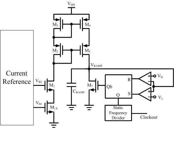

Hello everybody,
Please help me with this.
I'm doing a clock generator from a ramp and the figure is shown below.
My concern is although using the circuit I was able to obtain a 1MHz from a VDD=2.7~5.5V,
the resulting ramp is not within the VH and VL limit. Am I doing the right track?
Shown below are the resulting simulations..
Thank you for taking time reading this one.
---------- Post added at 08:57 ---------- Previous post was at 08:56 ----------
I'm using VH = 1.2V and VL = 0.6V
It is caused by comparator delay. In silicon, comparator offset will also lead to difference.
For the valley, this structure could not be equal to VL. The discharging is so fast.
I don't understand why the lower limit of the Vramp goes down to negative.
When NMOS M7 is turned off, its channel charge will be injected to Cramp. Carrier in M7 is electron that carries negative charge.
All I need is the clock pulse with 50% duty cycle. I really don't know what is the expected graph for the vramp.
If so, you don't care much about the ramp signal. 50% duty cycle can be achieved by d-flipflop.
