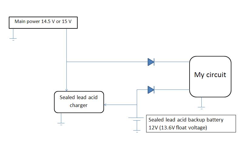

and final my idea is in this picture , tell me your opinion
another question, can i use relay such as this picture for main switches in my diagram, connection main power and backup battery in lose power for a fraction mode?
Yes, it's a SPDT relay. It will work.
and your opinion about my final idea (final diagram)? is it good ? and don't have any problem?

for your purpose I think this can help. for charging connect charging circuit to battery
regards ani
Hi tpetar,
you can avoid D1 since the rectified DC is more than 12v
regards ani
