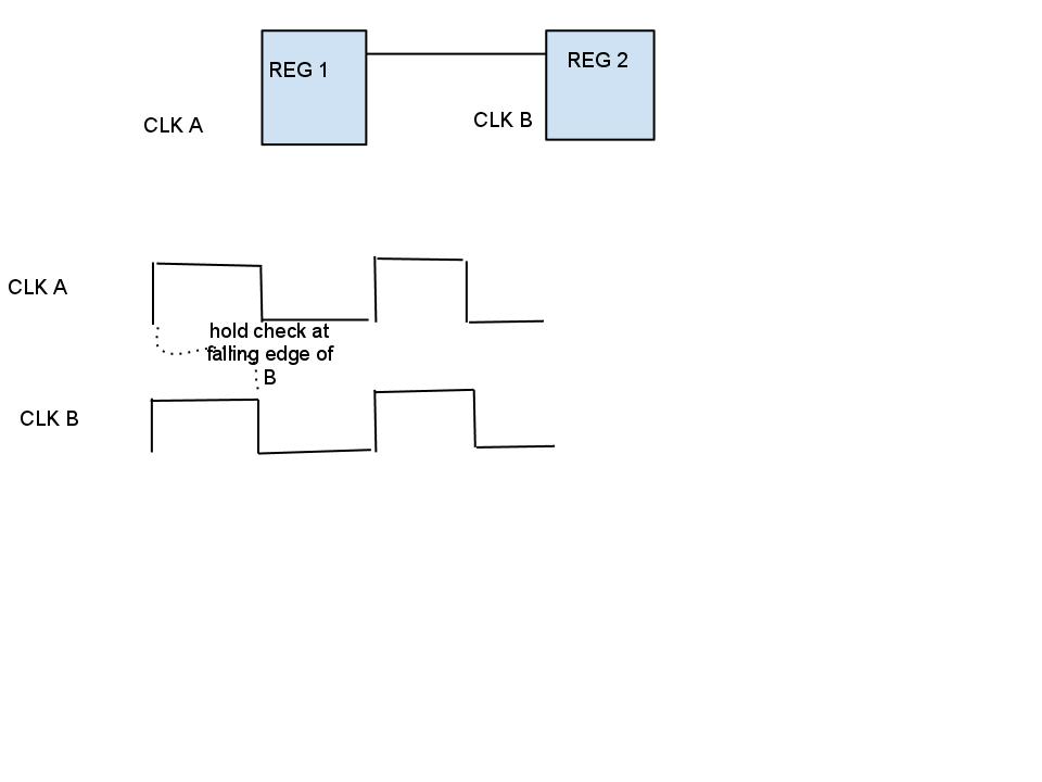

https://obrazki.elektroda.pl/10_1320307338.jpg
which edge will be considered for hold slack calculation ( positive edge or negative edge)?
Since we are launching the data and capturing in the same cycle, how is hold defined. will hold not depend half clock period in half cycle path?
As indicated in the diagram. The capture flop is a negative triggered flop.
Just think the edges of the capture where the data gets latched.
So here the hold check for capture shown in the figure is for the second pulse of the launch clock and not first one.
Hope its clear now.

Hold check is done one edge prior to the capture edge.
Now if ur clock A has 10ns time period so its edges are 0 10 20 30 40
clock B also at 10ns but fall edge its sensitive edges are 5 15 25 35
So for data being launched at 10ns will have
setup check at 15ns
hold check at 5ns

Since no one answered this last question, I will even if a few months late. YES, in a half cycle path your hold check will be affected by your period.
Here is how I like to think of it.
In the case of rising to falling on the same clock, data leaves flop1 at time 0 and must reach flop2 by the next falling edge which is half the clock period. This is the setup check.
Now, you need to make sure that the data doesn't change before it is flopped. This is the hold check.
You can think of this as checking hold at one edge prior as suggest by phoenixpavan, but hold also checks the next edge of the launching clock against the same capture edge. If the clocks are the same, both of these methods are the same and most STA tools will move the edges to the earliest alignment anyway.
Using his example, data launched at 10ns will be captured by the neg edge flop at 15ns. The next launch edge is at 20ns, so you need to check that the data launched at 20ns arrives after the original capture edge of 15ns. An STA tool will use the earliest alignment, which would be 10ns and 5ns just as he determined.
However, when you start using mixed frequencies it is apparent the two methods are not equivalent, and you must use the worst case.
For instance if your clock a is 2x your neg edge clock b.
So clock a has pos edges at 0 5 10 15 20 25 ...
and clock b has neg edges at 5 15 25 35 ...
The setup check by default uses one cycle of the capture clock, so capture will be at 15ns, and the worst case launch edge would be at 10ns giving you a 5ns period. This will be moved to the earliest alignment which is launch at 0ns capture at 5ns.
Now the hold check will be the next launch edge against the same capture edge, or 5ns and 5ns. This will not be reduced to 0 and 0 because 0 is not a valid capture time for the negative edge clock.
If you used phoenixpavan's methodology, you would still launch at 0ns, but now check hold one cycle earlier on the capture clock which would be -5ns. Moved to the first positive time alignment you would get launch at 10ns capture at 5ns, which is incorrect and allow massive hold violations to be missed.
