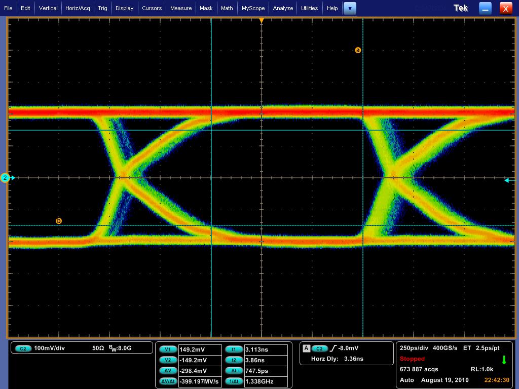

Tx Waveform problem
HELLO ~ :cool:
I've designed and measured CML type tx buffer. But the waveform has some problem.
If there are some capacitive loading, I think slow rising time is ok, but this waveform has the inflection point at the crossing point. Thus it makes EYE more worst.
Where is it from? Just typical waveform with hard capacitive load? or design has some problem?
Re: Tx Waveform problem
Hi pansoo,
Could you please give some detail on your designed buffer ?
Just typical scheme like below. But it has PreEmphasis function additionally.
