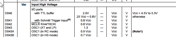

to answer your question I need to read both datasheets: microcontroller and zener.
so it´s best you check the datasheets:
microcontroller: Look for V_IH. Maximum port pin input voltag to detect HIGH signal
zener: chart: min voltage at 100uA.
If zener voltage is higher then you are on the safe side.
Klaus
Okay, but how am I supposed to read this:
My VDD is 5V so it's simply 2V?
So: 2.1 V at pin means HIGH and 1.9V at pin means LOW?

You are correct. I forgot you use ADC... My mistake.
Logic input levels:
Yes. Every input signal >2.0V means HIGH.
No! You have to look for V_IL to know what the valid levels for LOW are.
Usually the limit is at about 0.7V. Everything below is LOW.
Input voltages 0.7V .... 2.0V are not valid! The input value (HIGH/LOW) is unknown. Avoid these levels. They may cause problems. (Oscillations, EMI, increased current consumtion)
