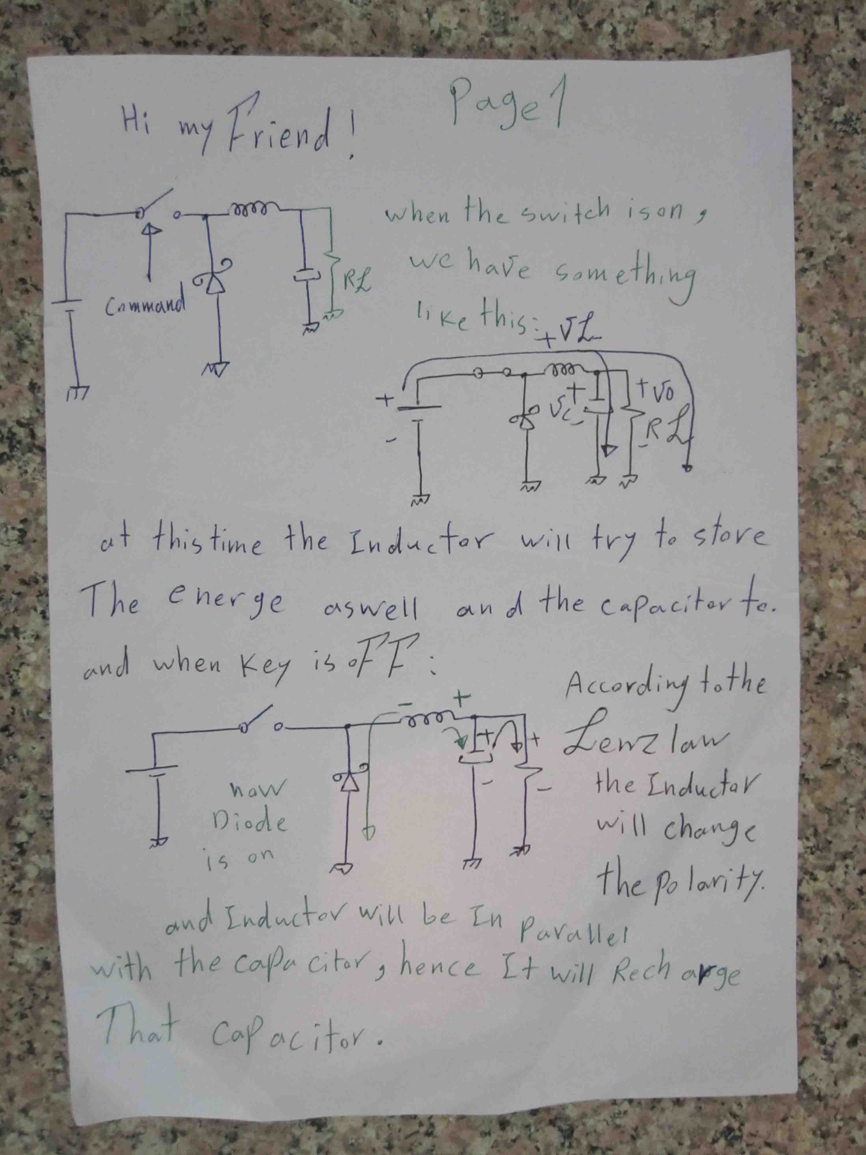

Hi again
I don't think that this IGBT is good for your aim . see page 3 of it's datasheet , please . why , IGBT ? why not mosfet ? for instance , if your input voltage isn't higher than 50 volts , an IRFZ44N can be a good choice . or if your voltage is higher , an IRFP450 or IRFP460 can be brilliant .
Are you familiar with basic of a buck converter , really ? if , no , i can describe it for you .
Anywhere , even you can use a simple bjt , in parallel with a fast diode , instead of , 2nd switch .
1. remove the diode (when the circuit is still running). the diode seem to not be playing any role right?
That diode , has two purpose , in this circuit :
1st one is , to keep the switch from minus and high voltage . the cause of this high voltage in minus polarity is lenz law .
If you see the voltage across the inductor , it will be an AC square wave .
2nd : to recharge the capacitor when the switch is off .
2. remove the diode + inductor + capacitor. the LED still lit up. but of course, if with the cap, the LED lit brighter.
Our eyes , can't understand , the frequencies , above 50 HZ . use an oscilloscope . ( smart eye of each engineer !! )
And about the LC filter at he out put , give me the value of your input voltage and maximum and minimum output voltage and current , thus i can help you in : how to design the out put filter .
There are two simple formula available .
Good luck

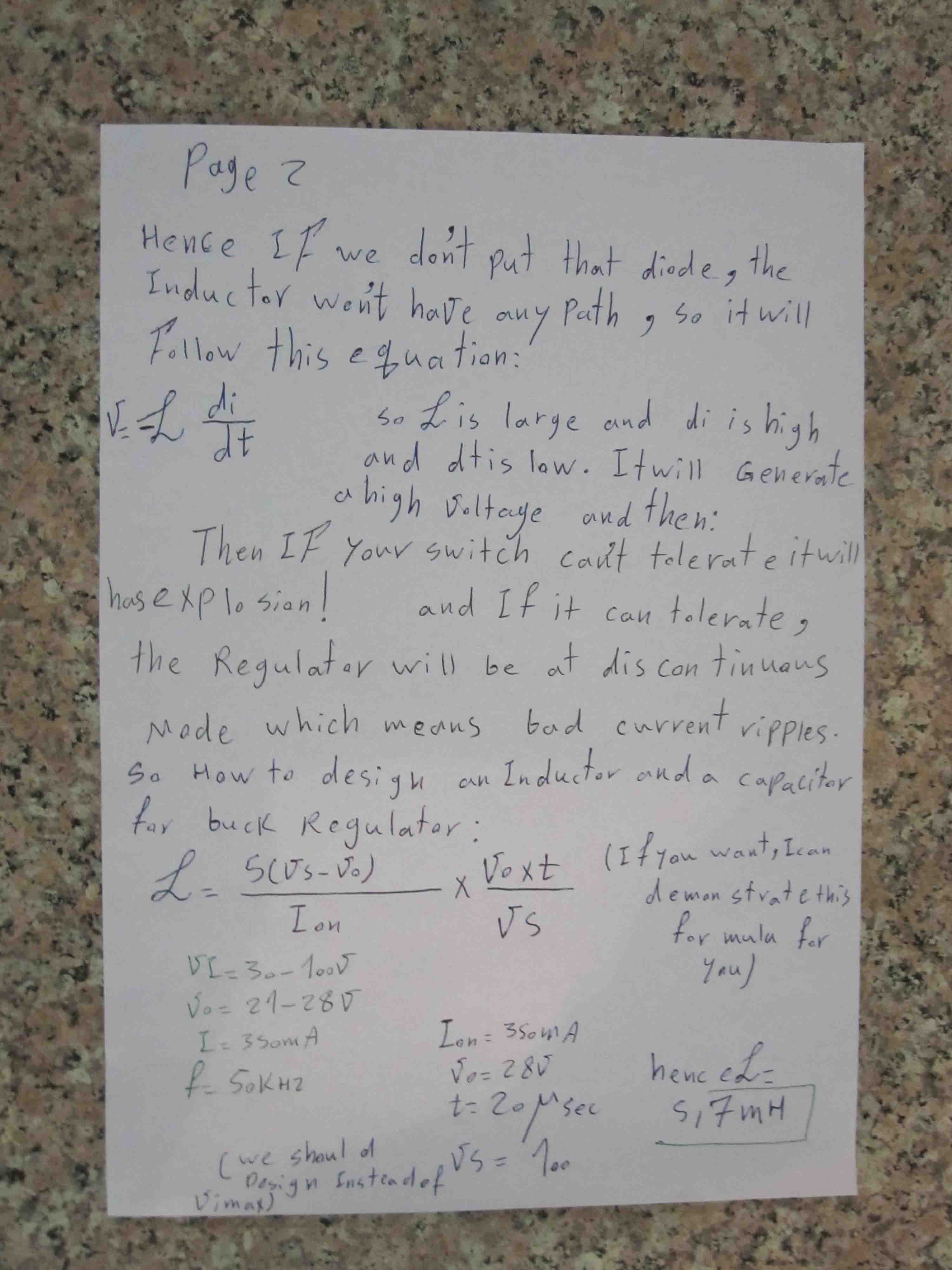

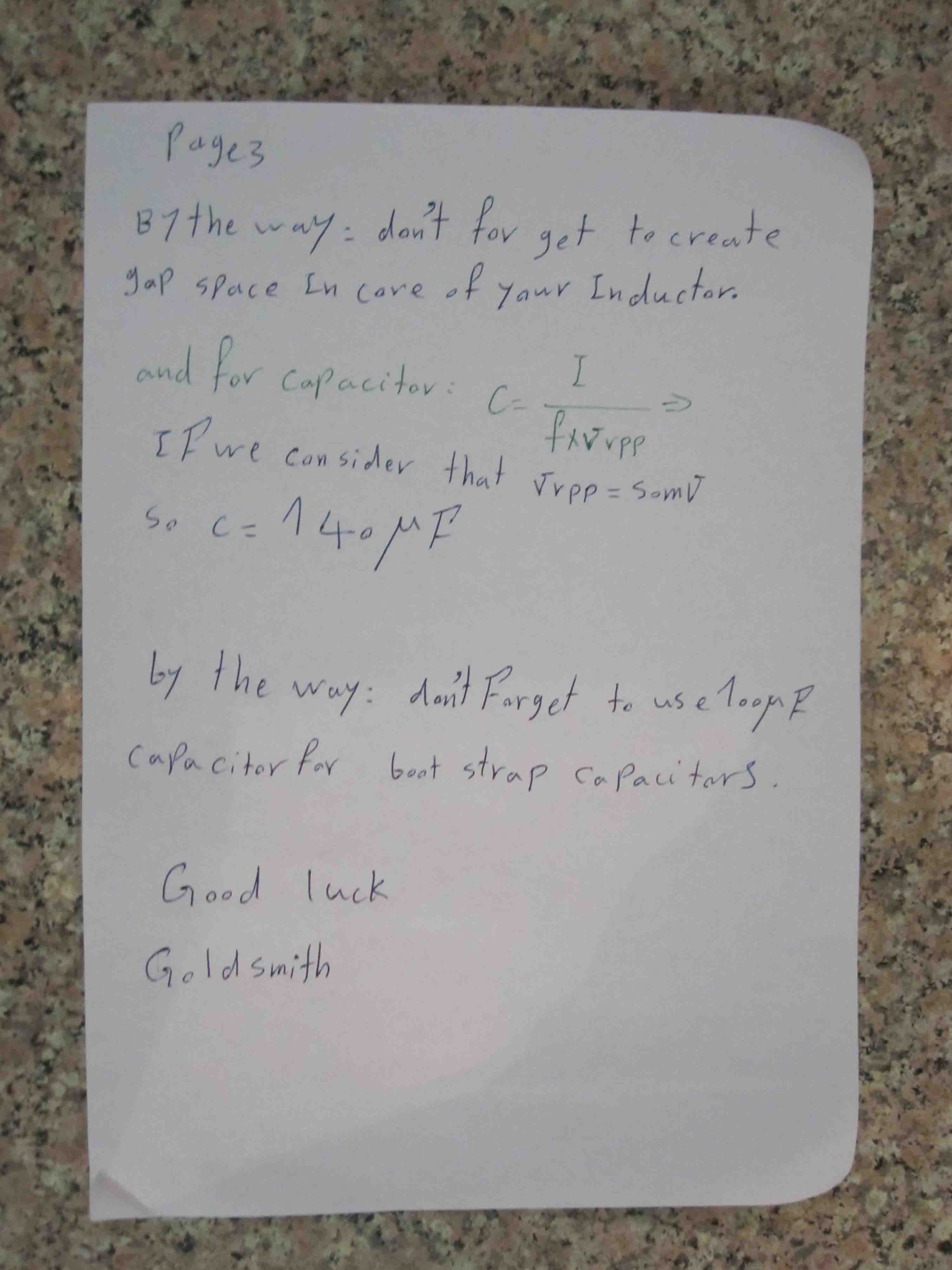

Hi again
At first , if you want achieve this voltage from 240 volts , it is possible , but be careful , this voltage is DC and means that it is , more dangerous than AC voltage . so , pay more attention to the safety .
And about IGBT : it can handle your aim , but not as well as possible . you can change it with better one , or you can use a mosfet , for instance , IRF740 . the VDSS of that is around 400 volts and ID= around 10 amperes and rdson is about 0.5 ohms ( approx ) .
Well , i wrote 3 pages for you , read them and then if you have any problem , ask me again , please :

Hi again
At first , about the values that i told , those are the best values for a buck converter with your specifications .
And about the attached waveform , i can see a little overlap , and it means that you have to increase dead time . and be sure if you increase dead time the problem will solve .
