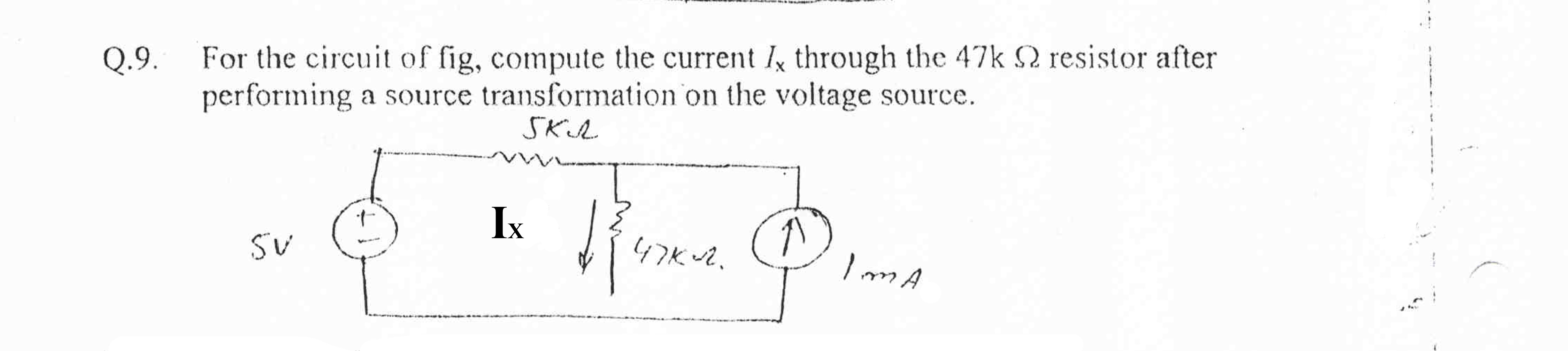

Hi dear,
solve the below circuit
the answer is 192µA
how to solve source transformation circuits
By converting the voltage source into current source and 5K ohms parallel resistor
We get an 1mA current source flowing upwards.
Now two 1mA corent sources in parranel can be added up(since in same direction)
this sums up to 2mA.
Now applying current divider formula
Current through branch having 47kOhms=
Rsistance in other branch(5K)
----------------------------------*Total current
sum of resistances(5K+47K)
5K/52K*2M=192 micro A

vicky said:
Hi dear,
the answer is 192µA
Was that a test, question, request or order?:?:
