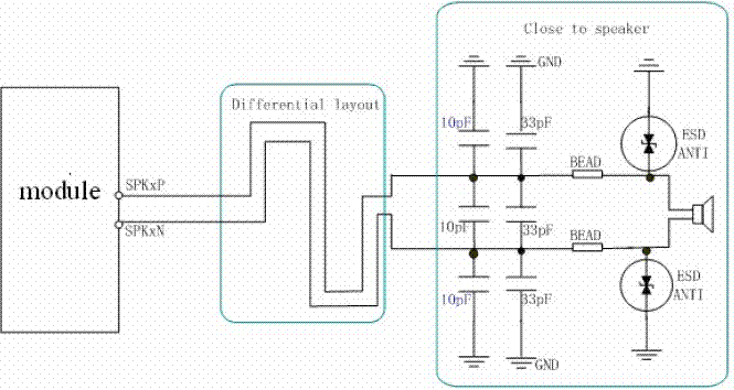

hi,
i'm working with sim548c module in this i have a problem in audio interface, ihave to inter face two way audio from the pins MIC1P,MIC1N,SPK1P and SPK1N. in this when I connect speaker no problem working properly, but when i connect MIC via those pins like MIC1P and MIC1N with in 1 minute the cal gets disconnected and the modem gets reset, i'm using the same circuit as referred in the SIM5X8C_HD_V1.01.
