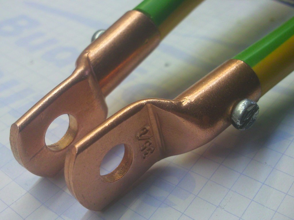

Transformer:
Transformer is a part of disassembled amplifier from Technics (SU-V670). Cross-section of the core is 23,5cm2. Although this dimension may seem to be rather small, the power of the transformer is significant enough. Secondary winding consists of almost 2 meters of line LGY 35mm2 (10mm of thickness plus isolation). Window with dimensions of 46,5mm x 9,5mm allows for placing 4 spools of the cable. At 660mV for a spool, 4 spools give 2,6V, at 950-1000A current with short-circuit. The transformer has one advantage in comparison with microwave transformers – it can be connected to the mains all the time and does not overheat. Due to that, there is no need to mount a fan to cool it. A number of holes in the housing provide passive cooling.

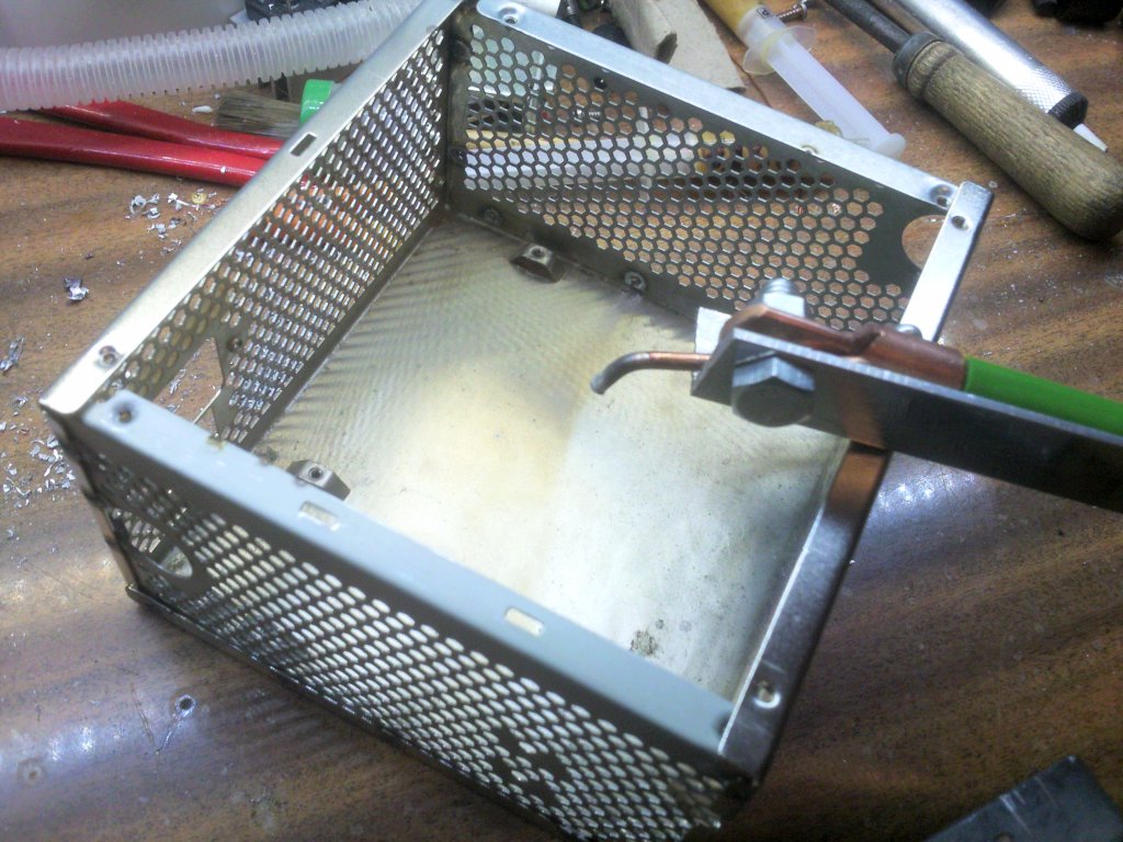

Construction:
Housing of the transformer and electronics is made of elements of ATX power supply housings, combined together. Copper ring terminals 35mm2 were soldered at the ends of the secondary wire. Arms are the aluminum angles 2x2cm. They are also important since they dissipate heat from electrodes, what allows you to perform more weldings in a certain time. Electrodes are copper wires DY 10mm2 (approximately 3,5mm of diameter). They are tightened between the ring terminals and arms, 10mm screw, they pass through a 3,5mm hole in the screw. Such direct connection ensures very good electric contact and heat dissipation. Electrodes can be mounted at any angle of any length, so that you can reach different areas of the welded elements. Method of mounting prevents the electrodes shift even under strong pressure. Working length of arms is 24cm.
