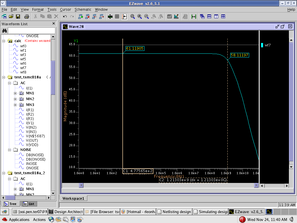

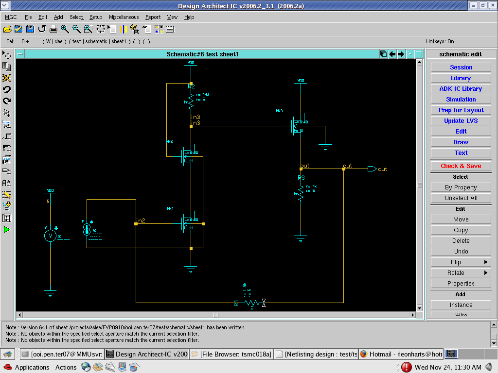

Anyone out there, Can tell me how do i know that i have already achieved maximum transimpedance gain ?
All i know, i need to fix my L(transistor)=0.18um, and my input current as 30uA.
Circuit
Bandwidth and gain
Currently, i am able to achieve 61dB for this design for 1.25 Gbps.But i don't know how do i know that it is maximum ?does it have anything to do with bandwidth ?or noise ?:???::-(

Cascode structure will help to increase gain.
ya, but my problem is i don't know which value is optimized for my design.Since W value for transaistors MN! and MN2 will effect the gain, and R2 and Rf will also affect my gain.I don't know which to adjust so i can max my transimpedance gain
