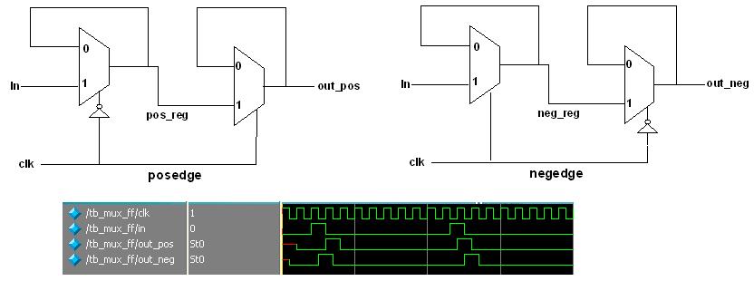

Hi all,
Below is the verilog code for posedge and negedge flipflops using mux.
I have also attached the pictorial representation of the circuit.
Verilog code :

correct me if i am wrong.....thanks
Re: posedge & negedge flipflops using mux....correct me
That is not the correct way to code a negative or positive edge flip flop if that is what you are trying to do. To correctly synthesize a flip flop with verilog you need to use posedge/negedge keywords. Here is an example of how to code verilog flip flops.
