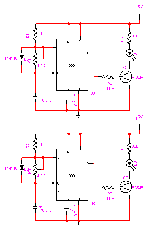

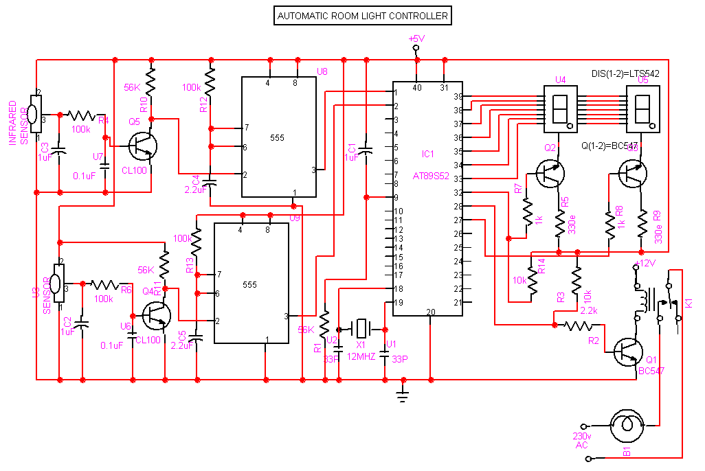

i will be using 2 PIR sensor...to check out for human detection
