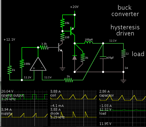

A buck converter is a simple way to demonstrate how feedback works.
20V is dropped to 12V. The output is regulated at 12V, any current. (The simulation has a load of 1A.)
The feedback signal acts to regulate output, by causing the op amp to turn on and off when output strays too high or low.
