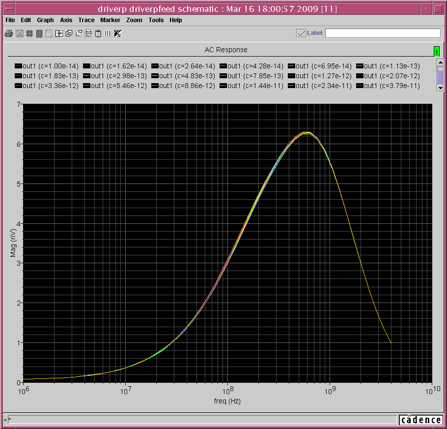

hi,
I'm designing an lvds driver like the figure below. But it have to go in 1Gb and the outup load is killing it.
I've a cutting freq. of 500 MHz aprox. and my output load is two 100 Ohms resistances and two capacitor of 10 pF.
Can you explain me how can I increase its speed?
lvds speed

uumm, it seems to me that maybe it is the cmfb that is limiting your speed
why don't you remove the cmfb and put an ideal block to see if then you can get it, later on you can add another cmfb circuit
BTW you should be able to have less than 10p on each brand before getting to the transmission line, but you should model the bonding wires and the transmission line, they should be your final limiting factor for speed. you may need to match the impedance at the output of the lvds to get as high as 1ghz
BTW2 Are you sure you need two 100 ohms resistors in parallel? Shouldn't it be only one?

increase lvds speed
Go step by step:
1 get rid of the cmfb
2 make the output transistors as wide as needed for the load
3 make the predriver fast and strong enough for those transistors
4 design the cmfb (I cannot help you much there, I'm not sure if you need to go up to 500Mhz, I think that it could be enough with less)
I think that in all this you need the pair of resistors and don't forget to model your pads and lines. It really is critical

If you want the output is IG, which means the time t=1/f=1.0e-9. however, your output RC constant is R*C=100*10*1.0e-12=1.0e-9. so it is clear that you cannot achieve this . Unless your cap is around 2p. So the RC constant time now is 0.2e-9. NOW your lvds can drive it .
Re: increase lvds speed
The problem is that the output impedance is a model of link and I can't control it. Are there any kind of technique to rise the speed of this lvds?
I've seen a lot of papers for 1-2 Gb LVDS using this kind of schema.
I've enclosed one pictore of ac analisys. As you can see, I've a resonance freq of 1 Gb
