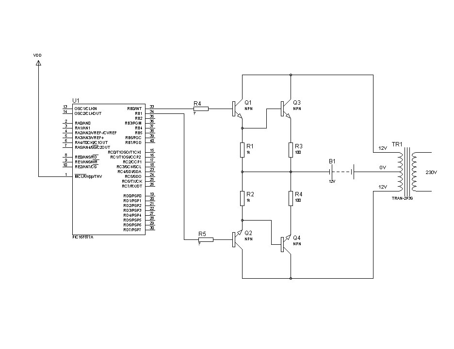

I changed my circuit, PNP to NPN.
This is my inverter circuit diagram.
How calculate R4 and R5 values?
With your diagram i dont think you need any negative voltage,
Simple way is simulate the whole circuit (also with load connected); and adjust resistor values to work Transistors within their limits.
Thank you,
In your diagram above R3 and R4 has 100ohms resistor which enable small amount of current to flow through collector,they should be change to a very low value may be 0.1ohms.

Also to calculate for the value of R4 and R5,you have to sellect a suitable gain of the transistor say Beta=40 then transistor IC then you can find you ib,since you know you voltage to the base Vb, you can find Rb.
