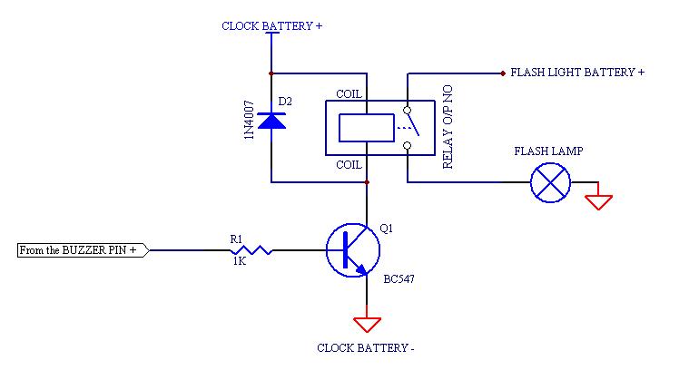

well,
now you need to have these things ready,
1. A General Purpose soldering board and materials for soldering like soldering iron ,lead or any alternate arrangement where you can carry out these.
Components:-
2. Transistor - BC547 or equivalent
3. Resistor - 1/4 Watt - 1K
4. Diode - 1N4007
5. Relay - SPST ( With just 1 NC Contact )
Coil Voltage - 5VDC (A small Relay)
Now, Look at the circuit attached.And wire the components on the general Purpose board as shown in the circuit.
A Very small amount of basic knowledge in electronics is mandatory.
Get back if you have any doubts, and definitely you will have it.
what is the clock battery voltage.If it is not or more than 5V, then there has to be a slight modification in deriving the coil voltage for the relay.But basically ,the circuit remains the same.
That circuit may not work. In the battery alarm clocks I've played with, the buzzer's (+) goes to the battery (+). The buzzer's (-) goes to an open collector NPN transistor or N-MOSFET. You would need a PNP transistor ahead of your NPN. Emitter to battery (+), base resistor (100K) to buzzers (-), and collector to a load resistor (10K) to battery (-). Your R1 to the PNP's collector.

please clarify,with a circuit diagram if possible.

Before I post a schematic:
What's the voltage of the clock...1.5V?...3V?
What 's the voltage of the light?...1.5V?...3V?...4.5V?
What's the current draw of the light?
The buzzers I've encountered in clocks are not self-contained buzzers, but piezo elements that are pulsed by the clock circuit.
1. The open collector output is meant to drive a very small load (piezo element) and could not drive a light directly.
2. The output circuit would try to pulse the lamp at the alarms high frequency, and the lamp may not respond fast enough to light.
Ken
Ken
Yeah, I dont want to remove the relay part.That should be still there.
The coil of that relay can be directly driven by that clock open collector instead of that external transistor is what i meant.Still I am not sure of the capability of that open collector.
Since most battery clocks use either one or two AA batteries, even if the clock output could handle the relay coil current (doubtful), where are you going to find to relays with 1.5V or 3V coils?
