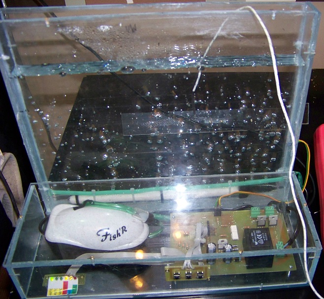

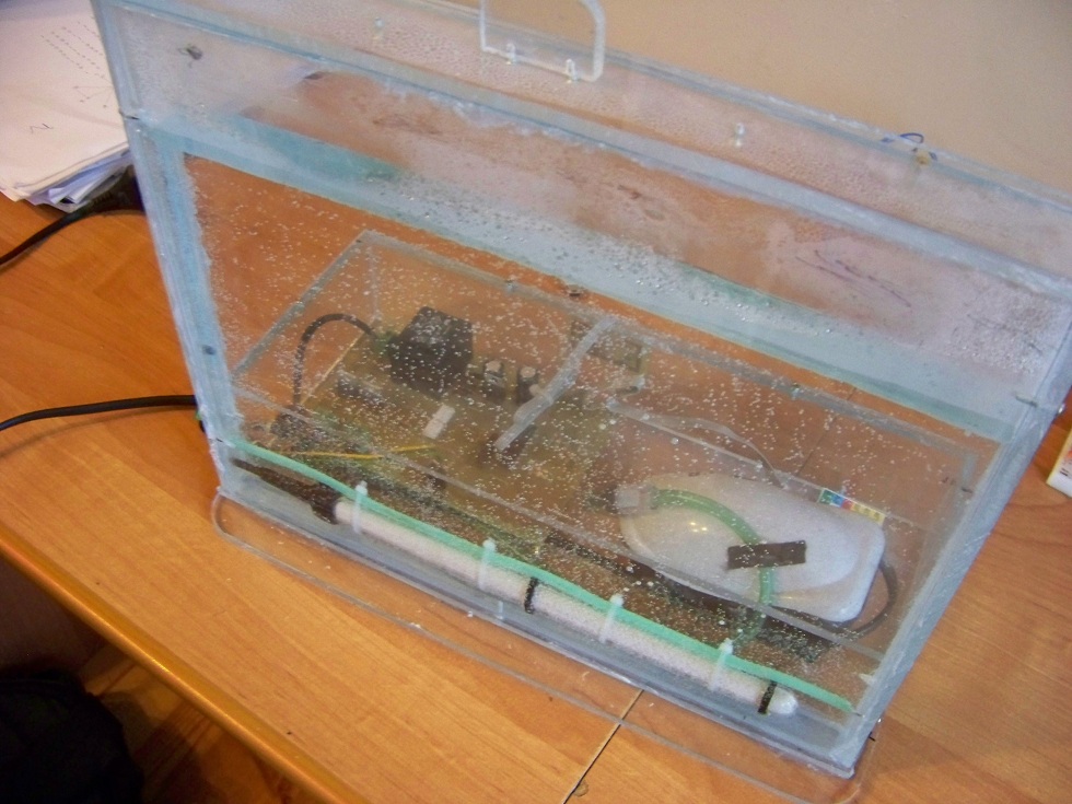

Home made etching tank on Attiny2313

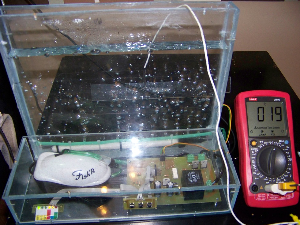

Dimensions of the etching tank: 25x30x3,5cm (it is about 1,4l of acid). A board with dimensions of an A4 page would fit it.
Heater used is SKALAR 150W, it heats up 1,3l of water at 20 degrees Celsius to 40 degrees Celsius in 15 minutes, 40 to 50 degrees Celsius in another 9 minutes.

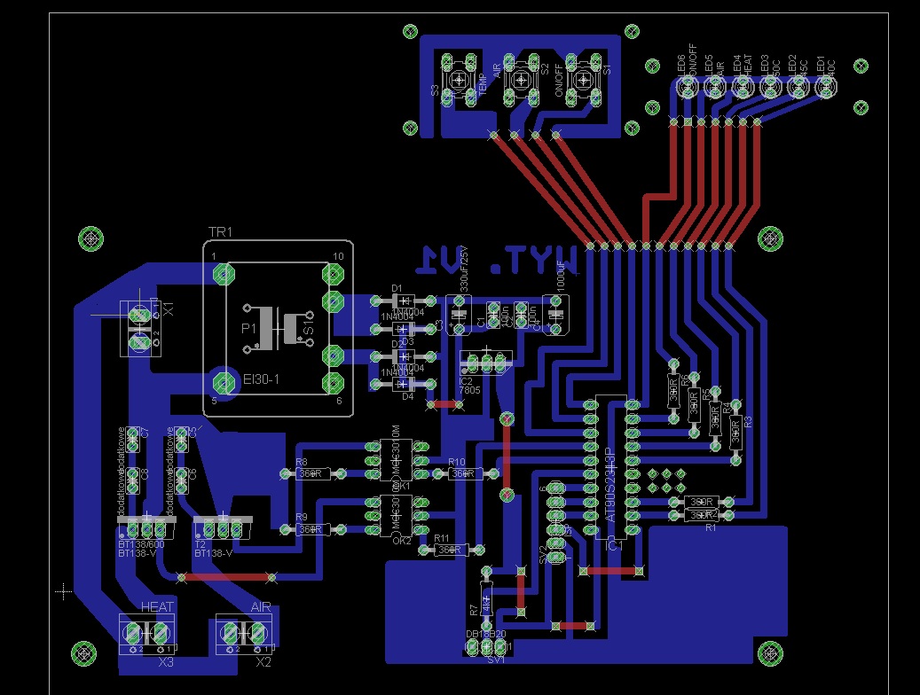

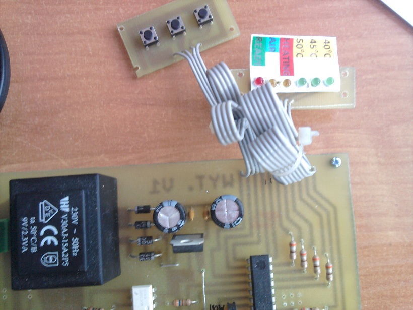

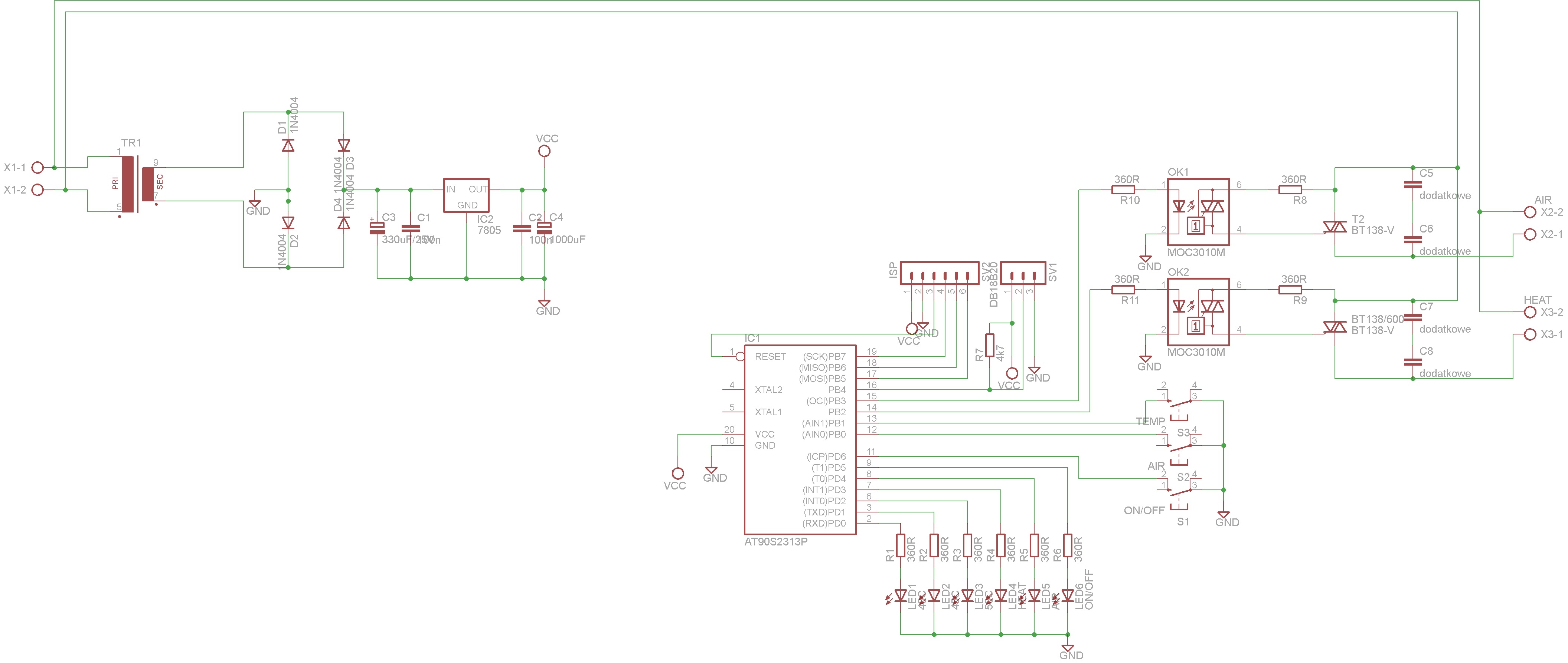

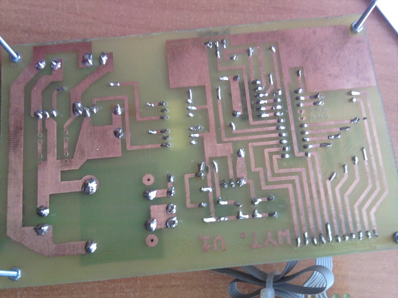

The system was designed on Attiny2313. 6 LEDs indicate the operation of the etching tank:
  1. temperature was set on 40 degrees Celsius
  2. 45 degrees Celsius
  3. 50 degrees Celsius
  4. the heater on
  5. aerator mode
  6. power

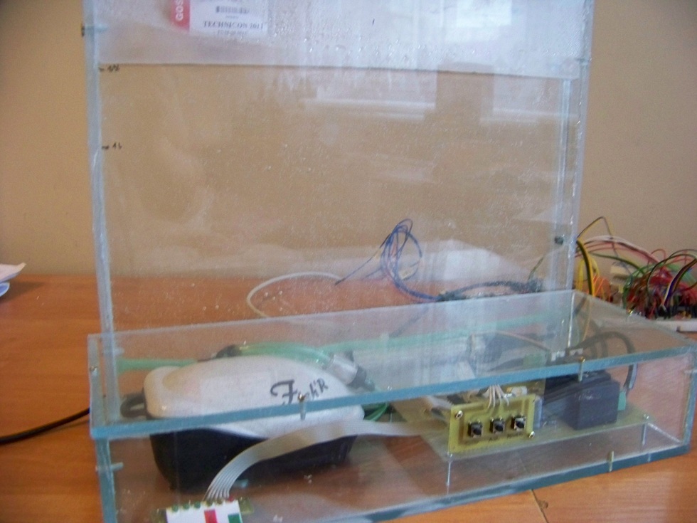

Control is done using three buttons, first is used to set the temperature, second one for aerator and the last one turns on the heating.
The aerator can operate in four modes, 1s of aeration and 3s pause, 1s and 1s pause, continuous and off.

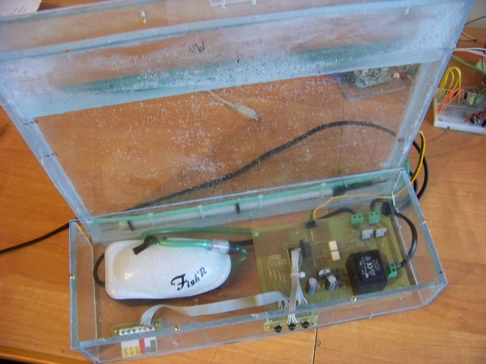

The board with buttons is outside. The entire device is made of 4mm plexiglass, glued to the aquarium with the adhesive. It is solid, you can add a faucet for draining acid.

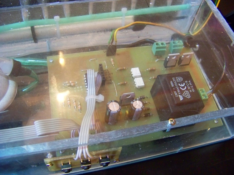

Elements used:
  • heater
  • pump and hose
  • return valve
  • plexiglass
  • transformer
  • triacs
Program was written in C, here is the code:
Kod C - [rozwiń]
