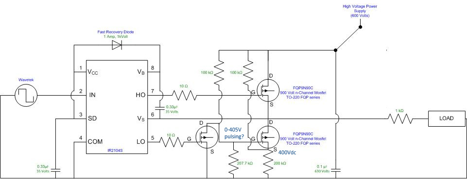

FvM, I thought about something similar (using a voltage divider) but realized the pin used to sense the voltage between the two FETs is also used as the source connection to the upper N FET and thus needs to be connected there to turn on that FET. I think you'd have the same problem using an optocoupler, isolation transformer or AC coupling.
I tried the IR2104 and it is working great, based on the reference circuit in their datasheet. With that said, we want to look at pulsing between 400V and 600V instead of 0 to 600V. I was thinking about pulling up the the output to 400V and disconnecting the lowside FET, however I suspect that will complicate gate driving from the IC as one would need 405V to drive the gate of the high side FET.
Any ideas or comments on the complexity of being able to do this?
Thanks
Switching between 400 and 600 V imples a sufficient low impedance 400 V source (maybe a bypassed voltage divider in some cases, depending on the load current), and a floating (respectively stacked up the 400V source) supply for the gate driver.
The alternative for "switching" arbitrary voltages would be class A or AB high voltage linear amplifier.
FvM, yes our thoughts are along the same lines. We came up with the approach that we'd create a 400V source with a divider off of the 600V supply (let's assume the 600V supply is sufficiently low in impedance while the load is sufficiently high in impedance). And that would feed the source of the low side FET rather then ground. To turn it on, I was thinking we use a level shifter to put the needed 405V on the gate of the low side FET (fingers crossed this won't add enough propagation delay to screw up the phase alignment). Much thanks if you could look over this concept and offer your comments (waiting on parts to actually build it).
It can't work this way. Two points are missing:
- bypassing of the 400 V voltage divider
- restricting the gate voltage to the permissible range
The shown circuit would immediately blow the gate of the low-side FET by applying -400V to it. Whatever you use to adjust the correct voltage range, you should have voltage limiting means to enforce keeping of the maximum values. Unfortunately most gate driver and voltage limiting circuits will feed a current into to 400V supply, so a high resistance divider most likely isn't a good idea. A divider with a source follower would give a less compliant voltage source. Capacitive bypassing to absorb the switching currents would be required anyway.
I fear, you also didn't yet realize, that the boostrap circuit relies on switching the output to ground, which isn't longer the case now. But you would be still able to use an IR21xx driver, if you power it by a fixed supply stacked up above the HV.
You didn't - by the way - mention the involved load impedance.
Oh, you're right! I'd be pulling the gate of the low side FET below it's source! to the tune of -400V
The load impedance is very high but not fully characterized (that is part of the experiment), I can say that is somewhat capacitive, but the bootstrap topology has helped dramatically in terms of overcoming the challenges associated with a capacitive load. With a 0 600V wave 50/50 duty cycle, we were seeing this load pull less than 10mA RMS.
I need to think on your comment regarding the stacking of the IR driver over the HV supply. We noticed that the chip seems to phantom power itself without even suppling Vcc for some reason. Seems to work well whether we power Vcc or not.
