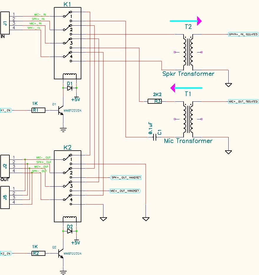

I have a circuit that needs to switch the audio between a telephone headset and the telephone into an effects circuit. When the circuit has no power, the unit needs to switch the headset back to the phone, bypassing the effects unit by default.
I'm currently using relays as shown below, but the current drain from the coils are unacceptably high, could anyone suggest an alternative?

Thanks, I've used silicon audio switches before, but as I stated above, I need the switch to conduct in the normally closed state when NO POWER is available, silicon switches would not.

What is the amont of current in your application?

I have used in some project optically isolated MOSFET relays which is normally closed (depletion fet).
I am not sure how they perform in an audio application
You need about 3 mA for the LED.
Panasonic is one manufacture http://pewa.panasonic.com/pcsd/product/pmos/index.html
But there are other ones also.
Perhaps you can use a combination of enhancement and depletions FET's for the switch function and skip the MOSFET relay.

You could use bistable relay instead. Current is needed only to change state of relay. Capacitor can store energy needed for switching and current required by system would be negligable.
