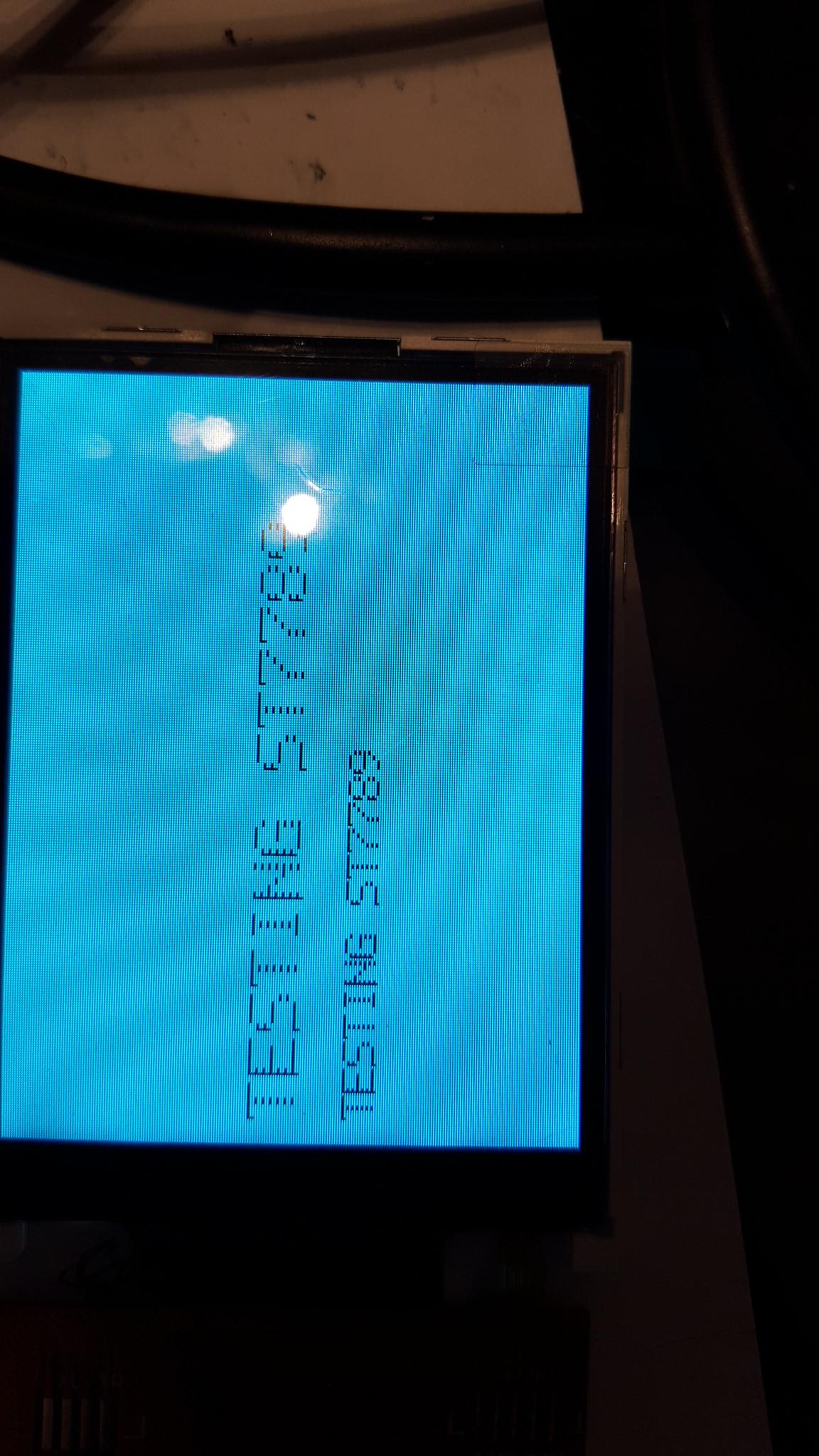

has anyone used ST7789 2.4inch TFT display ?
aliyesami
Full Member level 6
Jan 7, 2010
369
1,296
USA
4,190
I was using ILI9341 2.4inch TFT and its obsolete and replaced by ST7789 controller but the code iam getting from newheaven display is not working .
has anyone used this display and can please share the initialization code.
I am attaching my initialization code and the program code. its displaying text in jagged form and also displaying blue instead of yellow.
https://obrazki.elektroda.pl/8255400600_1462902194.jpg

 * NewController.cpp
 * Created: 2/4/2016 4:05:33 PM
 * Converted the C project into C++
 *  Author: SAMI
 * controller.c
 * Created: 1/28/2014 12:39:18 AM
 *  Author: Sami Ahmad
header file location:
C:\Program Files (x86)\Atmel\Atmel Toolchain\AVR8 GCC\Native\3.4.2.1002\avr8-gnu-toolchain\avr\include\avr
C:\Program Files (x86)\Atmel\Atmel Toolchain\AVR8 GCC\Native\3.4.2.1002\avr8-gnu-toolchain\avr\include\util
#define F_CPU 11059200UL                                    // CPU frequency
#define F_SCL 100000L                                       // I2C clock speed 100 kHz
#include <avr/io.h>
#include <util/delay.h>
#include <stdio.h>
#include <stdlib.h>
#include <string.h>
#include <avr/interrupt.h>
#include <avr/eeprom.h>
#include "controller_displayshutoff.h"
#include <inttypes.h>
#include <ctype.h>
#include <compat/twi.h>
#include <math.h>
#include <stdint.h>
volatile int       _height=320,x=0,y=0,h=0;
volatile int       _width=240;
char            buffer2[12] ,xmtbuff[5],recvd_chars[100],recvd_buff[100],cmdbuff[100],buffer[12];
int         i=0;
int main(void)
    TFT_setup();                            // Initialize the TFT display
    _delay_ms(100);
 disp_color(YELLOW);
while(1) {
 disp_color(YELLOW);
 TFT_String(100,10,"TESTING ST7789",BLACK,YELLOW,3);
 TFT_String(140,10,"TESTING ST7789",BLACK,YELLOW,2);
 _delay_ms(10000);
} // end Main program
 Procedure: make a command packet to send the current OCR register values across.
void disp_text()
    int i,j,k,a,b;
    a=5,b=5,i=0;
        for (j=0; j<5; ++j)
            for(k=0; k<10; ++k)
//              TFT_String(a,b,itoa(recvd_chars[i],buffer,10),txt_bg_color,txt_bg_color,2);
                TFT_String(a,b,itoa(recvd_buff[i],buffer,10),txt_bg_color,txt_bg_color,2);
//              TFT_String(a,b,itoa(recvd[i],buffer,10),txt_bg_color,txt_bg_color,2);
                b=b+30;
                i++;
            b=5,a=a+20;
        a=5,b=5,i=0;
        for (j=0; j<10; ++j)
            for(k=0; k<10; ++k)
                TFT_String(a,b,itoa(recvd_buff[i],buffer,10),BLACK,txt_bg_color,2);
                b=b+30;
                i++;
            b=5,a=a+20;
void DrawCircle(int x0, int y0, int radius)
    int x = radius, y = 0;
    int radiusError = 1-x;
    while(x >= y)
        setPixel(x + x0, y + y0, BLACK);
        setPixel(y + x0, x + y0, BLACK);
        setPixel(-x + x0, y + y0, BLACK);
        setPixel(-y + x0, x + y0, BLACK);
        setPixel(-x + x0, -y + y0, BLACK);
        setPixel(-y + x0, -x + y0, BLACK);
        setPixel(x + x0, -y + y0, BLACK);
        setPixel(y + x0, -x + y0, BLACK);
        y++;
        if (radiusError<0)
            radiusError += 2 * y + 1;
            } else {
            x--;
            radiusError+= 2 * (y - x + 1);
void DrawFilledCircle(int x0, int y0, int radius, uint16_t color)
    int x = radius;
    int y = 0;
    int xChange = 1 - (radius << 1);
    int yChange = 0;
    int radiusError = 0;
    while (x >= y)
        for (int i = x0 - x; i <= x0 + x; i++)
            setPixel(i, y0 + y, color);
            setPixel(i, y0 - y, color);
        for (int i = x0 - y; i <= x0 + y; i++)
            setPixel(i, y0 + x, color);
            setPixel(i, y0 - x, color);
        y++;
        radiusError += yChange;
        yChange += 2;
        if (((radiusError << 1) + xChange) > 0)
            x--;
            radiusError += xChange;
            xChange += 2;
void setPixel(int16_t x, int16_t y, uint16_t color)
    setAddrWindow(x,x+1,y,y+1);
    data_out(color >> 8);
    data_out(color);
void menu_button()
    fillRect(1,1,199,320,txt_bg_color);
    fillRect(200,1,40,320,header_color);
    fillRect(4,270,40,40,AQUA);
    TFT_String(8,275,"F1",WHITE,AQUA,3);
    TFT_String(50,270,"MENU",txt_color,txt_bg_color,2);
void fillRect(int16_t x, int16_t y, int16_t w, int16_t h, uint16_t color)
    setAddrWindow(x, x+w-1, y, y+h-1);
    uint8_t hi = color >> 8, lo = color;
    for(y=h; y>0; y--) {
        for(x=w; x>0; x--) {
            data_out(hi);
            data_out(lo);
void TFT_Text(int16_t x, int16_t y, unsigned char letter, uint16_t color, uint16_t BackGrnd ,uint8_t font)
    int i, j, k ,font_width, count;
    if (font==1) {font_width=5;}
    if (font==2) {font_width=10;}
    if (font==3) {font_width=15;}
    char mask = 0x01;                           //start looking at the bytes LSB first, then increment up to the MSB
    for (i=0;i<8;i++)                           //each character is 8 pix tall
        for (k=0;k<font;k++)
            setAddrWindow(x+font-1,x+k,y,y+font_width); //set address to the first column and prepare to write 8 pixels down
            for (count=0;count<5;count++) //each character is 5px wide
                if((Ascii_TFT[letter][count] & mask) == mask) //if the bit we're looking for is true
                    for (j=0;j<font;j++)
                        data_out(color >> 8); //write the color we want
                        data_out(color);
                else
                        data_out(BackGrnd >> 8); //write the color we want
                        data_out(BackGrnd & 0x00FF);
         x+=font; //increment to the next column
         mask = mask << 1; //increment the mask to the next-most significant bit
void TFT_String(int16_t x, int16_t y,  const char *pointer, uint16_t color, uint16_t BackGrnd, uint8_t font)
    int char_gap;
    char_gap=10;
    if (font==1){char_gap=6;}
    if (font==2){char_gap=11;}
    if (font==3){char_gap=18;}
    const char *Src_Pointer;
    Src_Pointer=pointer;
    while(1)
        TFT_Text(x, y,*Src_Pointer, color, BackGrnd, font);     //write the first character in the string
        Src_Pointer++;                                          //increment to the next character
        y+=char_gap;                                        //set the address 6 pixels to the right (one character is 5px wide)
        if(*Src_Pointer == 0) break;                            //break if end of string
void setAddrWindow(uint16_t StartCol,uint16_t EndCol, uint16_t StartRow, uint16_t EndRow)
    comm_out(0x002A);                                               //colum address set
    data_out((StartCol >> 8) & 0x00FF);
    data_out(StartCol & 0x00FF);
    data_out((EndCol >> 8) & 0x00FF);
    data_out(EndCol & 0x00FF);
    comm_out(0x002B);                                               //row address set
    data_out((StartRow >> 8) & 0x00FF);
    data_out(StartRow & 0x00FF);
    data_out((EndRow >> 8) & 0x00FF);
    data_out(EndRow & 0x00FF);
    comm_out(0x002c);                                               // write to RAM
