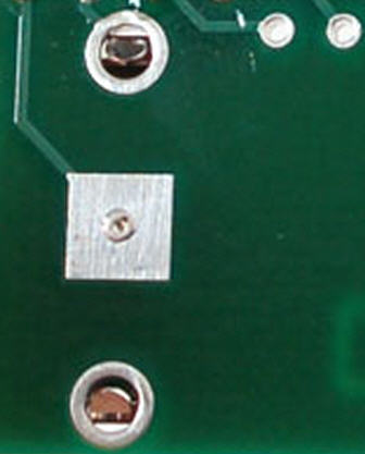

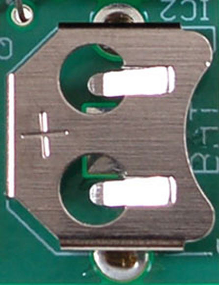

On the same pcb is a battery holder(KEYSTONE - 3001 - RETAINER, COIN CELL, 12MM); which requires large through-holes(approx. 2mm); the bat holder has two little clips like the bottom half of a letter t which snap/clip onto the inside of the drill hole(before soldering).....see pics below; I only need 2 for the battery; so to avoid buying 1000 x 2mm rivets & the extra tooling etc, ..I am thinking of top routing the 2 connections and surface mounting the clips instead...my only worry is the solder join taking the weight when a battery is inserted/ejected...

bottom...you can just make out the little half-moon baseplate of the clips...although in the pic they do not appear to be clipped onto the side of the drill hole as they should be

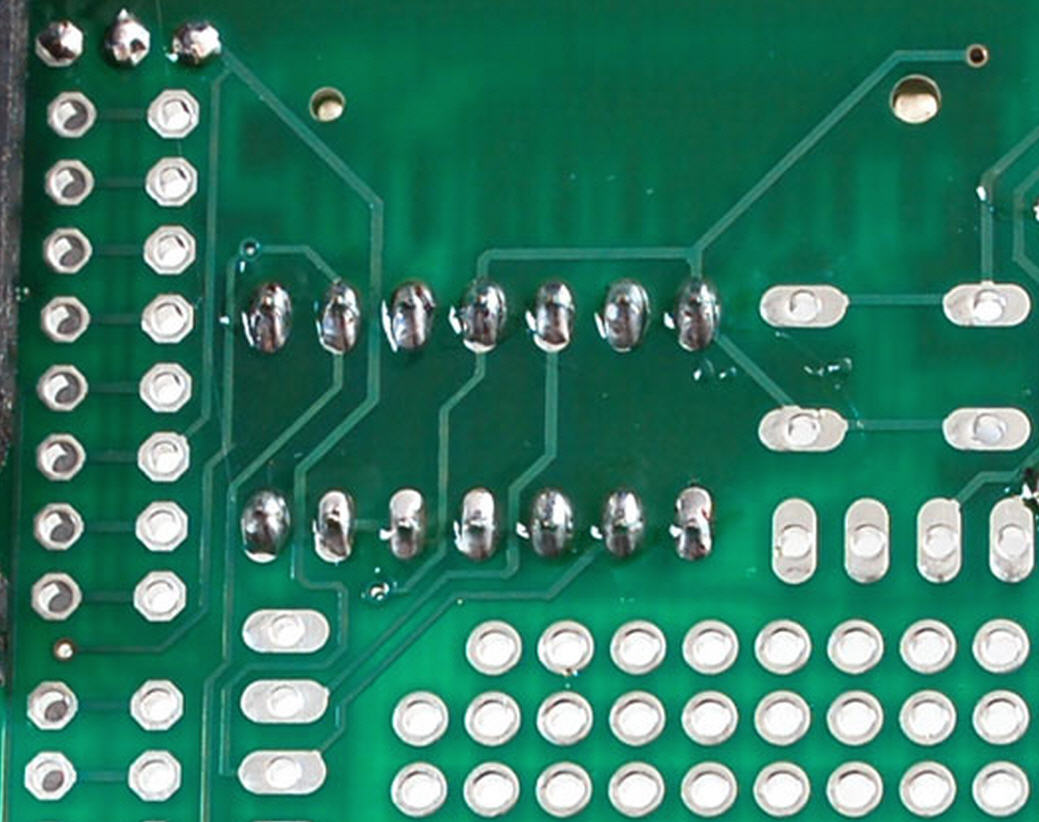

....do all the holes in this pic look like rivets(they look identical on both sides?)

As for your final picture, it will not load today for me. But, if the holes are identical on both sides, I suspect they are plated through holes, not rivets. All rivets come with a manufactured head (either funnel or flat), and you make the shop head. The shop head will have a slight curl to the lip. The flat head is easily distinguished from the shop head. My experience is only with the flat head, as that is what was available at the time. The funnel headed rivets may give sides that are more similar in appearance, but they are probably still not identical.
John
Edit: Must have been a slow link. The image loaded, and the holes do look plated through. A rivet will always stand higher than the PCB foil, and that does not appear to be the case in this example.

Obviously, you photo shows a standards galvanically through plated board without any rivets.

The said battery clip doesn't require rivets for the outer pins on the shown board, because they aren't connected on the component side. The center pad however will.

the middle mounting on the battery clip, maybe I can insert a track pin on bottom side and snip it level on component side..then fill the hole&pin with solder to create a pad
