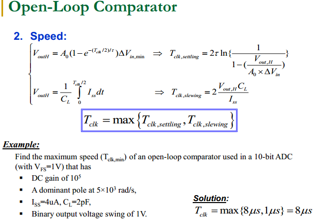

How I can determine minimum clock for a latched comparator?
I saw this formula to calculate it , but I want to determine it by Hspice .
