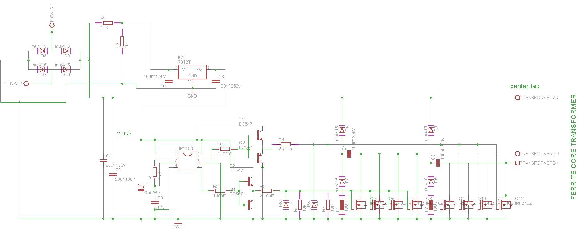

Ok so in other words using 110VAC I would use mains 110V and send it directly to a bridge rectifier to get 155Vdc then send that to an oscilator to generate the pwm signals to drive the transformer(Ferrite core). If so I will look for some example of different circuit that I think I can put together then make a schematic to show you.
thats what I came up with..... what do you think?
I do not know if an IR2153 can work push-pull like that because it is designed to be a half bridge driver to drive a single primary winding through a series capacitor.
the reason i used it is because I have been in a forum where persons have used it in this manner as an inverter where the applied 90v battery power for a push and pull of 40khz.
I could add some filters after the rectifier to smoothen the dc
Here is an Example of a Switching Power Supply.
that looks nice, I am assuming that even if I was to try that circuit that I could remove the diodes from the secondary of the transformer and use it as a center tap so that I could get dual polarity for an amplifier.
Yes, and the Output can be Either Stepped UP or Down in Voltage.
You could also have Multiple Output Windings.
Your Biggest Problem is Making a SUITABLE Ferrite Core Transformer for the Frequency of Operation.
Typically it should be wound with LITZ Wire, to better handle the High Frequencies involved.
