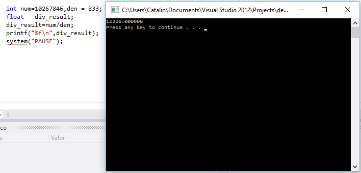

Hello experts,
I wrote the following lines of code in C:
int32_t num = 10267846;
int32_t den = 833;
float   div_result;
div_result = num / den;
I expected a value of some floating point type, but I am always getting 0 instead.
Please help me if there is anything wrong with my code and understanding.
Thanks.
IDE: Eclipse IDE for C/C++ Dev
MCU: STM32F3 series

You may want to review a C text book about automatic type conversion involved with arithmetic expressions. In this case, language rules require that an integer division is performed and then the quotient converted to float. To perform a float division, at least numerator or denominator must be casted to float before. E.g.
div_result = (float)num / den;

I do not see any reason that the OP code could not work properly if there weren't those int32_t. I do not know how DEV compiler works but in Microsoft Visual Studio int32_t is not defined.
Anyway, if changing "int32_t" with just "int" it works perfectly as expected. 10267846/833=12326.34574 but because of that int division in the "float" will be stored 12326.00000.
Yes you are right, I didn't look at the input numbers.
The shown expression gives 12326.0000, if one argument is casted to float it gives 12326.34573829.
It is indeed strange that it doesn't give the results as expected, but a good rule is to always use cast in order to avoid unpleasant surprises like this one.
