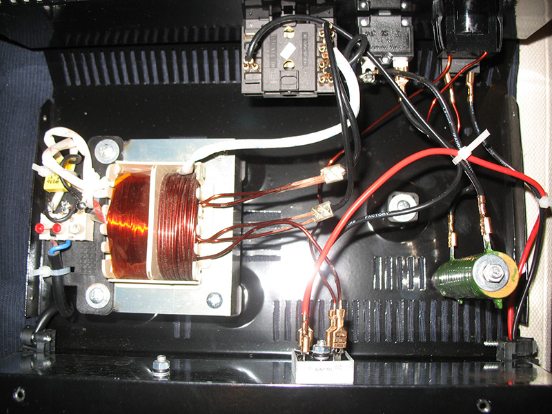

Hello
I have this charger: **broken link removed** and a solar battery bank made of these batteries: https://www.osibatteries.com/p-1052-enersys-powersafe-sbs-60-sealed-lead-acid-battery-120v-510ah.aspx connected in a way to get 24V 200Ah.
I know that this charger is not suitable for charging these batteries but that is the only one I got at this moment. So since it doesn't have a cut off at certain voltage I have found a diagram to a circuit that is designed for that but only for 12V: **broken link removed**
My question is: Is there a device that I can connect between my charger and batteries that has the features for a 24V system and that can cut off the charger at 27,6V when the batteries are full?

No reason why you can't use that small charger. A full charge may take 24hrs. Then check float voltage after current drops near zero.
Look carefully at the instructions for your Einhell charger. Does it have an automatic taper setting? This prevents overcharging (assuming the unit is of any quality to speak of).
From the looks of it, by itself it should charge your battery. Set it to 24V. Plug it into 230 VAC.
Its specs state it will deliver 10A (effective) to a 24V battery. A charge session will take several hours.
It's a good idea to keep an eye on it. As the battery rises to 28.8 V, charging current should decline.
However if it is still sending full current, then you must stop charging by disconnecting it.
I would not expect it to indicate a certain voltage at which it cuts off. The battery chargers which I have worked with, all detect battery voltage via internal circuity. Their meters indicate amperes, but not volt level.

To Brad: Here is the inside of the charger. I think it is very basic and I have not found any automatic taper setting so it could come to chuckey's idea trying to connect it to the solar controller.. :wink:

Once again thank you all for your recomendations. I think I will put a voltmeter on that charger to monitor the voltage.:wink:
The circuit with 3 trimpots is where you look. Two have red wax on top.
But, that red wax is on a ordinary screw that holds the 220V wires in place. There are no trimpots here. :-|
Ok bad eyes on photo. This looks like an unregulated charger. You must add a series regulator or simply put the AC on a timer. The SOC can be estimated from V @ 100mA load between 11.5 and 12.5 , I think or thereabouts.
