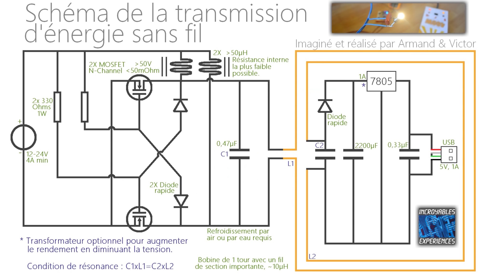

Sorry i forgot to mention. I probably will be using this circuit below (but without that 7805 regulator), the distance between the coils will be only a few millimeters. I would like to use the receiver coil to charge a battery, to charge it at 1C I would need about 40w. If I feed the circuit 12 volts and 20 amps (computer psu), would I be able to get 40w out? (20-30w is also okay but not much lower because then the charging wil take over 2 hours)

The self-oscillating MOSFET inverter is a rather bad design, it's neither guranteed to oscillate at all nor to keep the transistor maximum ratings.

Yeah... Would something based on a 555 be a better solution? I don't have used a 555 yet. Do you have a circuit that could let me adjust the frequency (maybe 50-200 kHz?)

A switch mode converter controller like SG3525 is probably better suited, 555 should be used with a flip-flop to generate symmetrical gate signals for two transistors. The advantage of the self-oscillating circuit is that it automatically meets the LC resonance frequency, an external controller must be tuned to it. But it promises better switching with less transistor heating.

Okay, do you have a circuit for this?
