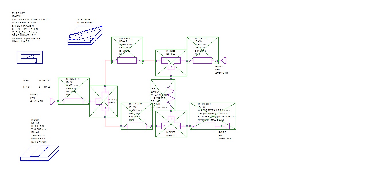

Volker sir,
Here with I am attacing schematic and layout of 4 wy Wilkinson power divider, Previous you replied , as you replied there is something wrong with your extraction and layout. I am attacing both ,I couldn't find out where I have done mistake. Design values for 4 wy Wilkinson power divider are as follows
Z(characterstic impedence) = 50 ohm, f = 3GHz, H=1.6mm, T = 0.036, relative permitvity = 4.4, tangential loss =0.001
I am expecting s- parameter values for above design values as follows for both schematic EM simulation
S(1,1) S(2,1) S(3,1) S(3,2)
-34 DB -3.0412DB -3.0412DB, -34DB
Presentently, I am getting the following values for attaching layout and schematic
-19.185DB, -3.4554DB, -3.4554DB, -7.129DB
Volker sir, please tell me how to get the expected results, please sir you try to make changes as you wish and attach the both schematic and layout for correct values obtained to you sir,Please try to solve this problem . If you have other schematic for above design values please send me sir, Sir I request you to make changes to my schematic and layout , send the expected values obtaind schematic and layout diagram sir.
I will be greatful to you sir.
As already posted multiple times: If you have set Rs=100 Ohm, your "long" resistor with length/width = ~10 will have ~1kOhm resistance, instead of the 100 ohm that we want.

Volker Sir,
Sir I got the expected results for 4 way wilkinson power divder, I followed as you said. I am very greatful to you sir, you helped more sir.I am realy very greatful to you sir.What ever you told that formula,I used that formula and did some settings changes of EM Extraction. By the *** grace you guided through the email, I am realy thankful to you sir. I am Ph.D student in one INDIAN university.If I need further help, I will contact you sir.
