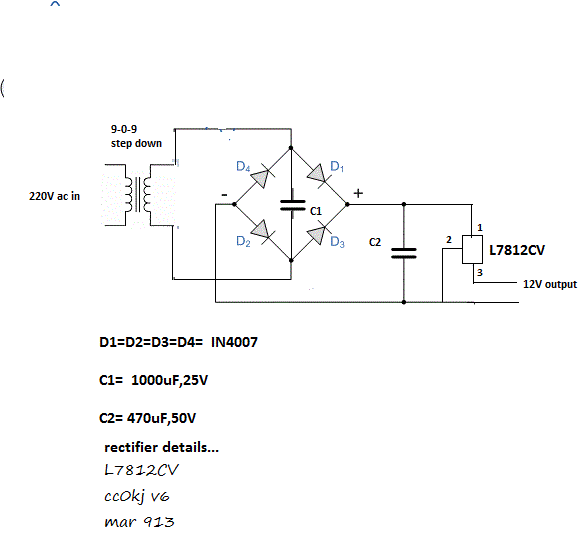

i am using a 12V rectifier i made myself...images here

Without seeing a schematic that has parts values then we are just guessing.
Maybe the "rectifier" is half-wave instead of full-wave.
Maybe the value of the main filter capacitor is too low.

here is the circuit...
now please tell whats wrong??

You show an ordinary transformer but say it has a center tap that is not shown so the label 9-0-9 does not make sense. Is it a 9VAC transformer or is it an 18VAC transformer?
The voltage regulator is missing the extremely important low value input and output capacitors shown on its datasheet that prevent it from oscillating.
C1 is in the wrong position. It will blow up!
If the internal temperature of the regulator reaches 150 degrees C then it will shut down. Its metal tab is made to be bolted to a heatsink with thermal grease between.
It looks like there should be a cap across the output.
And WTF is with the cap inside the rectfier?
Also i agree with the above post that the regulator should be heatsinked.
