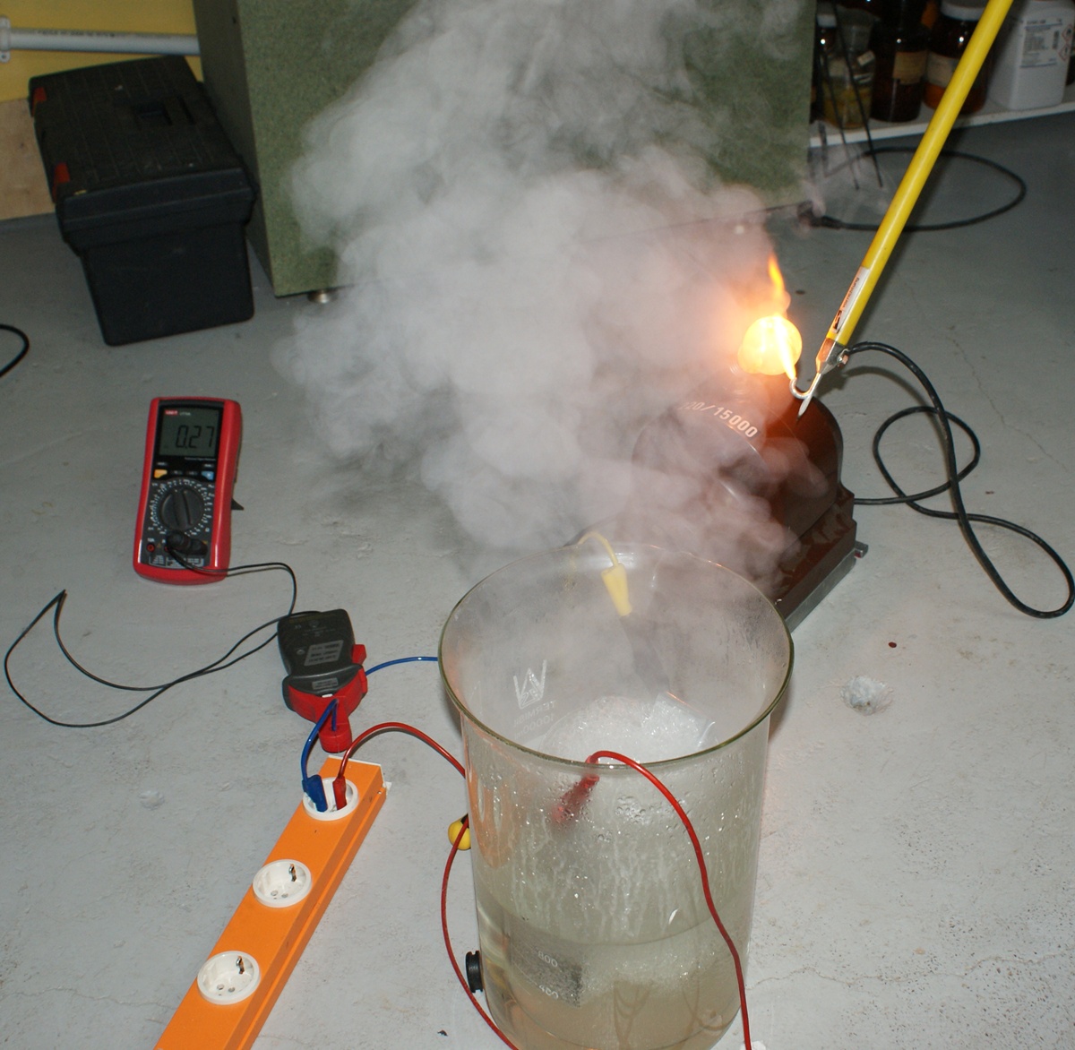

Instead of autotransformer with limited range of power, you can use two metal electrodes immersed in water, to which you should gradually pour saturated salt solution. Current clamps should be put on the cable and salt solution added gradually using a pipette. Then you can observe the current increase. The above picture on the left shows the behavior of the power regulator at a current of 27A.

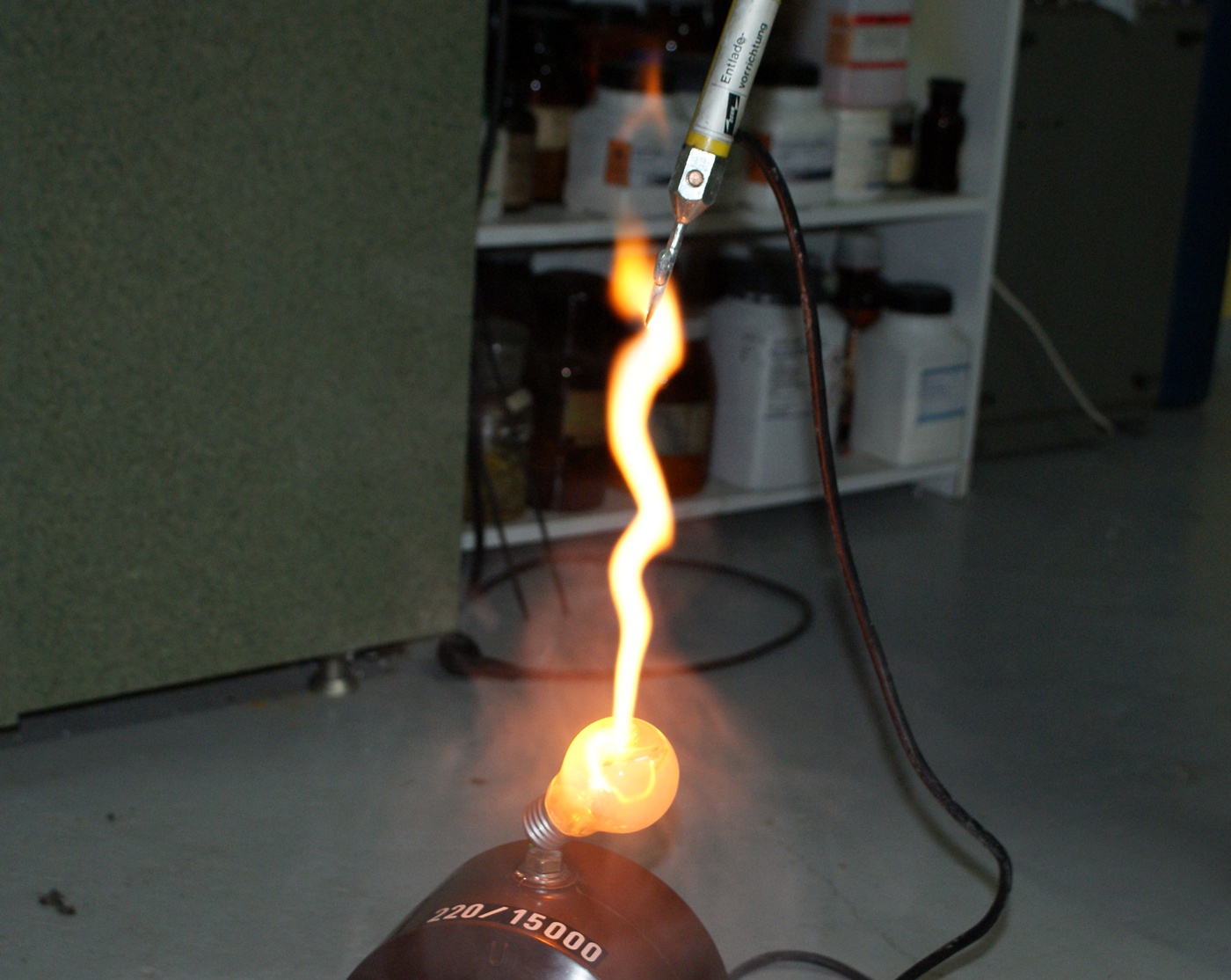

Pictures above show the effects of arc discharges on Jakubow's ladder. The electric arc lights up at the bottom and goes to the top, where it bends into a bow and extinguishes with a *****. The pictures also show how much heat is emitted – by observing the light refraction on hot air in some places.

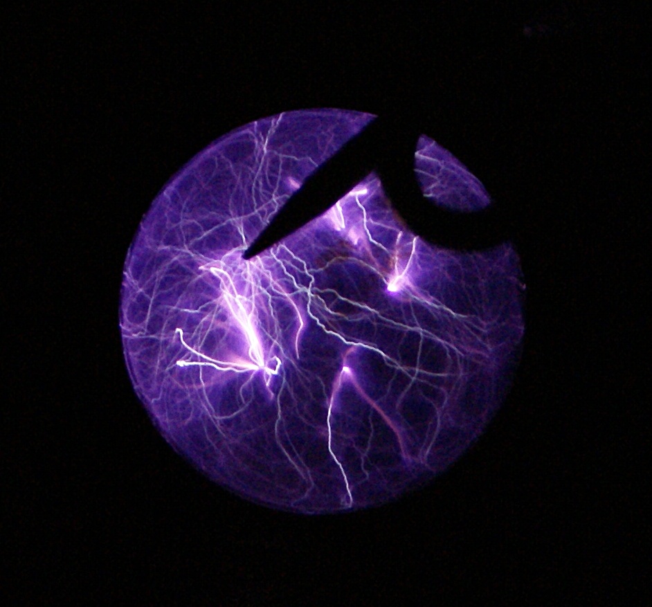

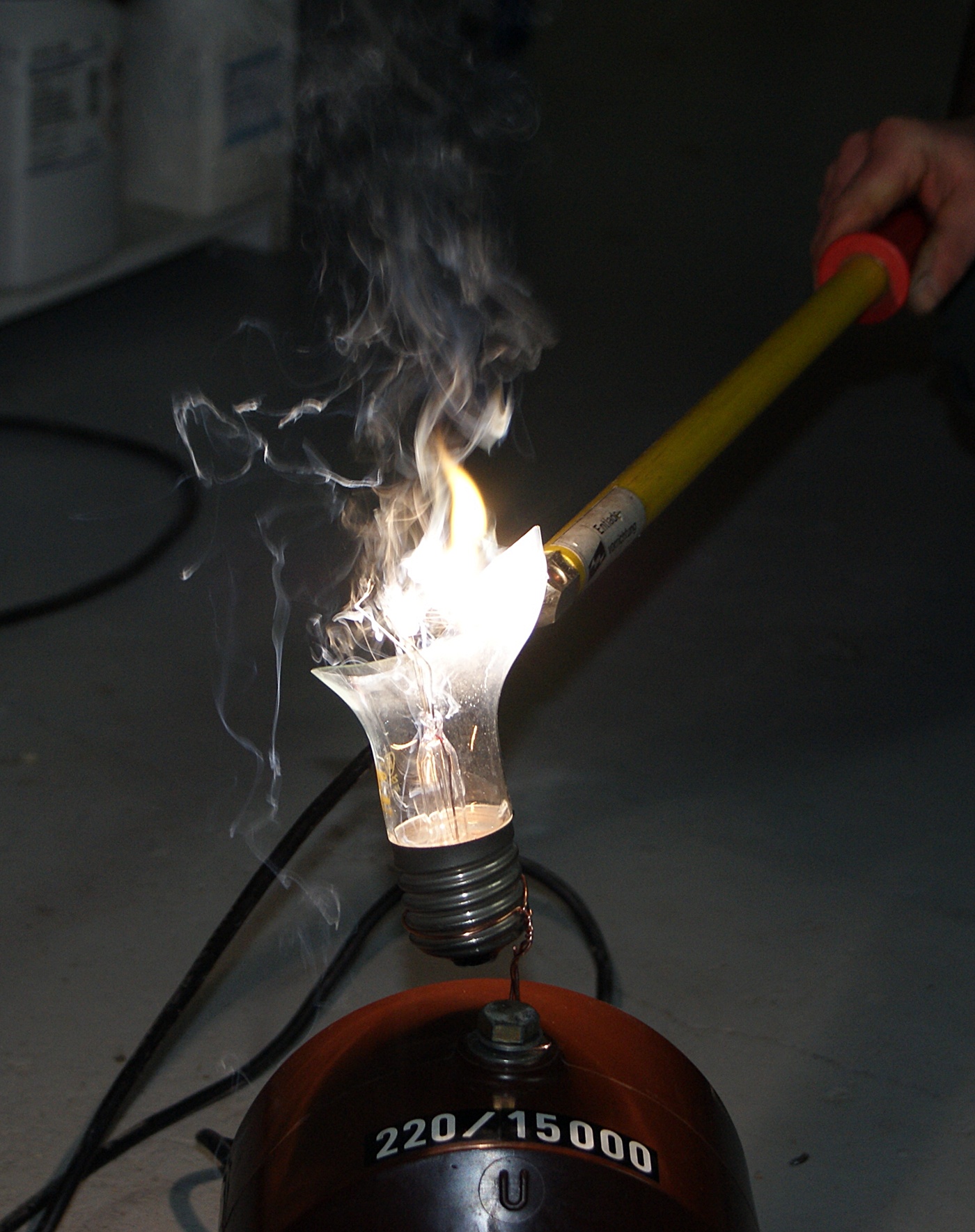

Above you can see the presentation of visual effects during discharges in a bulb.
Tests which ended with breaking the bulb.

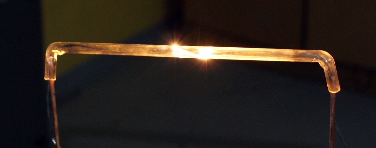

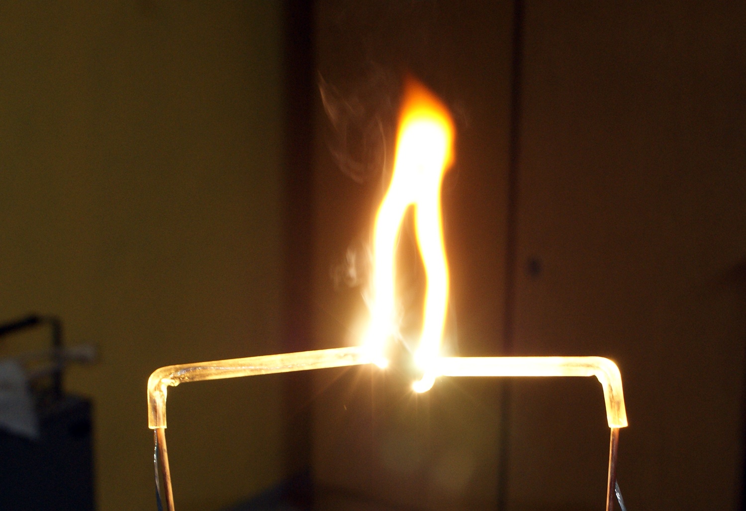

And there are some pictures of discharges in a glass pipe.
The transformer does not heat at all, even while receiving 7kW. This can be seen in experiments involving glass which starts melting.
