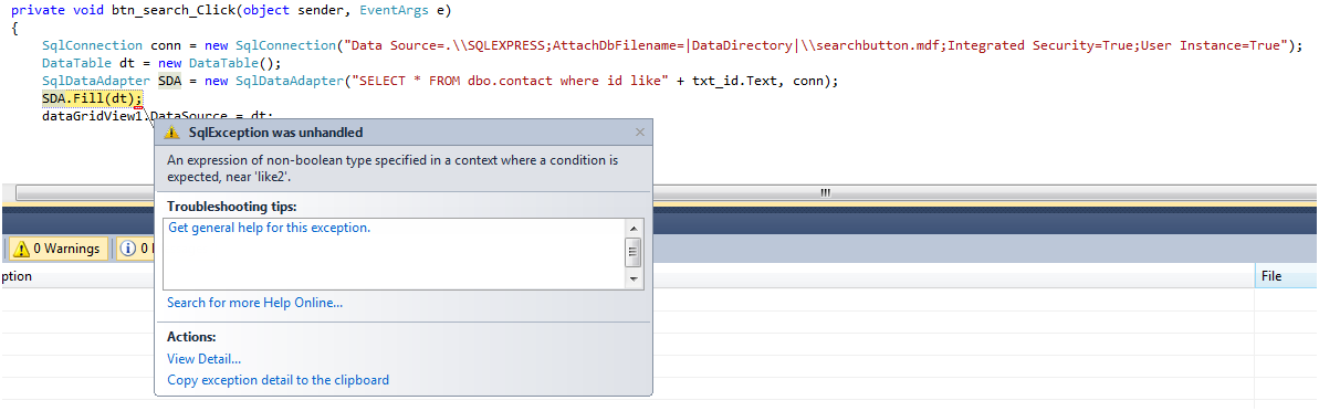

Hi
i want to create a simple search button in visual studio but it gives error, here is the code:

thanks in advance
What is this SQL statement "SELECT * FROM searchbutton.mdf where id like"
It should be table name instead of "searchbutton.mdf"
EX: if you want to search Employee data then table name should be employee so SQL statement as
"SELECT * FROM employee where id like"
thanks for reply but it gives error again,
I guess that you missed the single quote (') check this
("SELECT * FROM dbo.contact where id like '" + txt_id.Text + "'" , conn);
thank you so much, it is working now :))
