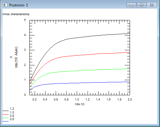

Thanks a lot..Your suggestions are very helpful i got different potential plots on the same graph..these potential plots are based on the different X-position values..But i want to see different potential plots depending on different gate voltages on the same graph..Kindly help me in this context also..Waiting for ur reply
Do you mean 2D contour plots overlaid or overlay of X-Y graph like an Id vs Vd at various Vgs?
Yes,I want to see both the things
(1)On the same X-Y graph like an Id vs Vd at various Vgs,similarly for Id vs Vg at various Vds,also
(2)I want to see potential(as a variable) graph along my grid at various Vg and Vd applied...Like,as soon as i increase my Vd from 1v to 5v through a step of 1v,my drain-body junction becomes more and more reverse biased hence I have to see potential increase in steps in the same graph..
Hoping that this tym i am clear with my doubt...
For example of the Id vs Vd vs Vg, I would run each Vd ramp (at Vg) and log it to its own file. So there would be a IdVd file for each Vg. These would be something like
idvd0P2.log results of sweeping Vd for a Vgs=0.2V
idvd0P4.log results of sweeping Vd for a Vgs=0.4V
...etc.
Now assume the terminals in Pisces are 1=D 2=G 3=S 4=Sub
In Postmini
Overlay->Read->Ascii->idvd0p2.log
This brings up the Read Ascii Data File window. Need to skip line 1 of the log file which is just the number of terminals. So
6->1
The X axis data for Vds (terminal 1) are in column 2 of a log file.
2->2
The y axis data for Ids (terminal 1) are in column 10.
3->10
All other defaults are OK so just accept this
ACCEPT
Now add this curve to the list to be plotted and label it
ADD
1->Label for curve
ACCEPT
Now plot it and add graph title (this is first plot with only one curve)
PLOT
1->Title for graph
PLOT
You should now have the graph with 1 curve on it. You can now add X,Y axis labels etc.
9->Vds
10->V
18->Ids
19->A/um
PLOT
Ok now to add more curves
EXIT
READ (accept defaults) enter filename.log
Since defaults should be ok just accept this
ACCEPT
ADD
1->curve label
ACCEPT
PLOT
PLOT
You should now have 2 curves, so just repeat this until you get bored stiff or run out of curves.

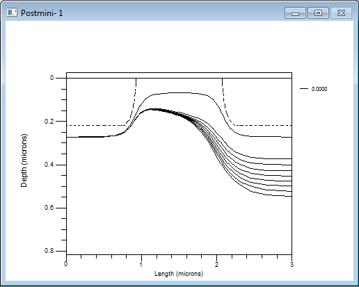

Using the previous example, lets set Vg = 1.2V and ramp Vd from 0 to 2.0V
I have saved a solution file for each Vd is steps on 0.2V from 0 to 2.0V
We will now display the progression of zero potential contour with Vd.
In Postmini main menu:
COMPARE
This gives the comparison contour plot
READ ->PISCES->whatever.msh ->Soln0.slv
ADD
What to see potential contour so select potential
Plot attributes for entry - use contour for zero potential
17-> 0.0
ACCEPT ->EXIT
PLOT
PLOT
Can now see the 1st contour plot which is coloured will filled contours
READ ->PISCES->whatever.msh ->Soln1.slv
ADD ->2 ->17 ->0 ->ACCEPT ->Exit
READ ->PISCES->whatever.msh ->Soln2.slv
etc
etc
PLOT
PLOT
Can now see all plots - but you cant because being shaded, they over write each other
so need to turn off contour fill.
EXIT to get back to Comparison Contour plot menu.
MODIFY
Select 1st contour plot and turn off contour colours...
1 -> 2 ->EXIT
2 -> 2 ->EXIT
etc
Now the plot has the contour for the zero potential as a function of Vds.
Hope this has helped!

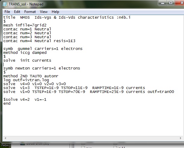

Now i have to see charge injection at drain side at different gate voltage fall times??..I had created a holding capacitor on the drain side..So can u please guide me how to proceed,if possible then only......
Set up drain contact with a resistance and capacitance, then solve the transient on the gate from gate on to gate off:
CONTACT NUM=<drain> RESIS=<??> CAP=<??>
SOLVE V<gate>=3.3 RAMPTIME=<??> DT=<??> TSTOP=<??>
Remember the capacitance is F/um and resistance is Ohms.um.
Look at channel charge contours as the deviuce is turning off to see where charge is dispersing.
Remember that in reality, the gate will not ramp off linearly. There will be some oscillation of the Vgate increasing in magnitude prior to the rapid drop towards zero. Then there will be a minimum below zero before recovery to zero volts.
These ringing effects will impact the charge dispersal. But worry about that later, just get the simple stuff working first.

Since this is 0.18um 4nm gate oxide, the maximum voltage on the gate should not exceed 5MV/cm so use 1.8V as the gate voltage. Try the following:
TITLE ... MOSFET 180nm transient on gate
mesh infile=7grid2
contact num=1 n.poly
contact num=2 neutral
contact num=3 neutral
contact num=4 neutral cap=0.5E12 res=1.0e3
symb newton carriers=1 electrons
method 2nd Tauto autonr
solve init currents
log outf=ivtran.log
solve v4=0 v1=0 v2=0 v3=0
solve v1=1.8 ramptime=5e-9 dt=1E-9 tstop=20e-9 currents outf=a0
solve v1=0.0 ramptime=5e-9 dt=1E-9 tstop=20e-9 currents outf=b0
end

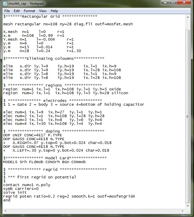

Hi colbhaidh.....Thank you very much for your support..As you said I need to have a capacitance on drain side to see charge injection,same was told by my prof..So i prepared the Holding capacitor on the drain side..What i did was,as i need to have two metal plates and a oxide layer to form the capacitor, i used my n+ region of drain side as my upper plate of capacitor and the oxide layer of 1nm (which is already there in grid) and put a metal (electrode=4) on it as bottom plate of the capacitor.so this will form my capacitor,so now i have to ground bottom plate(which is electrode=4)of cap while doing a transient and dc analysis..
Holding Capacitor=Ch
Gate Capacitor=Cg
Esi=E=3.9*8.854E-12
w=width of device=1um
Tox,h=oxide of holding cap=1nm
Tox,m=oxide of mosfet=4nm
Lg=gate length
Lh=Holding capacitor length
Ch/Cg = ((E*Lh*w)/Tox,h)*(Tox,m/(E*Lg*w))
= 4*(Lh/Lg)
so i can adjust the length of my Lh to get the required Ch value..Here i make it Ch=16Cg..As my gate length is .18um i made my drain region as 0.72um..i am attaching my grid..
But when i am doing the dc analysis,it is not converging for higher values of source voltages..also when i am putting the carrier=2 it is converging for higher values of source voltages then previous one????..Can u have a look at it and it will be so kind of u if u can correct it or give me the reason what can be the issue??..
hi.....I created the capacitor on the drain side....I run the transient analysis with different fall times and had saved the different solution files..
But when i am seeing electron concentration contour lines by the Overlay method i am not able to see any graphs..Am I doing correct method or not?? I have to look after electron concentration or the net charge contour??
Do i have to use Compare method instead of overlay so that i can see the charge injection??
Pleeeezzzzzz clarify my doubts....
Thank you in advance..

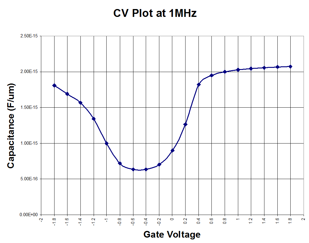

To get the classic CV plot (sweep -Vg to +Vg), use the following:
TITLE ... MOSFET 180nm CV
mesh infile=7grid2
symb newton carriers=2 electrons
solve init currents
log outf=ac.log
solve v1=0 v2=0 v3=0 v4=0
solve AC.**** freq=1.0E6 elect=1 vstep=-0.2 nsteps=9 VSS=0.01 outf=ac1
solve AC.**** freq=1.0E6 elect=1 vstep=0.2 nsteps=9 VSS=0.01 outf=ac2
end
run pisces2 0p18CV.p2 > tmp.txt
From tmp.txt extract the capacitances for electrode 1 into excel or something and plot vs Vg.

the overlap cap and the holding Cap form a potential divider circuit and hence also causes the error.
Error Voltage Vo=(Cov/(Cov+Ch))Vin..
So how to see it in pisces???...
One way which i think is to give 0.3v dc + 10mv ac on the gate terminal,as dc voltage < vth(0.4),transistor is always off and the error in output will be because of only
colck feed through,hence if I plot potential plot and find the voltage at output (i.e,drain terminal),if there is diff between source and Drain terminal voltage then that vil be
because of clock feed through only..So what i am thinking is correct or not???
Also in postmini one option is there "Window",i selected it and then selected the 'style' of windows,from that i selected the multiple window but the present plot(window wich containgraph of potential etc)window gets disappeared..So what is happening i dont know about it anything...Plz help me in this context also...Pleez i waiting for ur reply...
also get disappeared
Plz help me......
