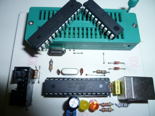

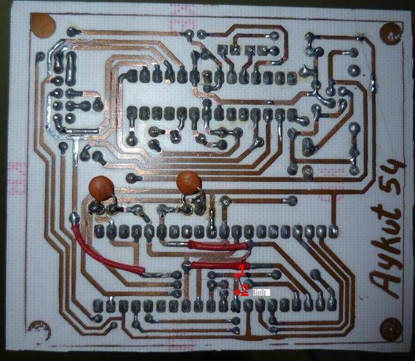

Oct 9, 2010 #1 gevv Advanced Member level 4 Joined May 6, 2006 Messages 102 Helped 11 Reputation 22 Reaction score 10 Trophy points 1,298 Location Turkey Activity points 2,080 USBasp - USB programmer for Atmel AVR controllers ( fischl.de - USBasp - USB programmer for Atmel AVR controllers ) zif socket version --------------------------------------------------------- bug pcb sub-1, 2 short-circuit and programing 40 pin atmel series pcb sub-1, 2, open circuit and programing atmega8, at2313 series all files (+ proteus ares pcb) attachments or Hotfile.com: Hébergement de fichiers par un clic: usbasp-zif.zip Atmel ATmega8 zif soket usbasp programlay Attachments usbasp-zif.zip 230.6 KB · Views: 364
