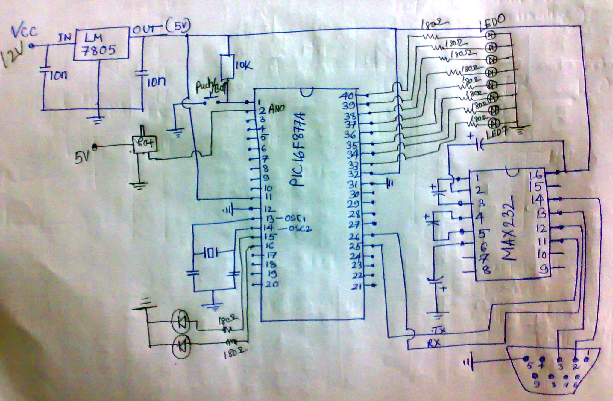

hii friend, i am a b.tech final year student... i need some help in the pic16f877a uart programing.
actually i am doing research on real time ECG prototype...so i need to transfer the collected ECG data from my body through pic16f877a to the uart continuously through rs232 cable ... i used to write a program by my own..lets get me ensure that is it will work or not....(m using MikroC)

actually i want to blink the LED connected to the PORTB pins... whenever the analog data found in the channel AN0 ,that is connected to the output of the ECG signal conditoning ckt, it will show the digital output in the LEDs..
UART communication is linked up but I am not able to blink the LEDs.. please solve me out..

Thanks for the replay abhishekdixit...
but it still not blinking the LEDs connected to the PORTB and PORTC.. i have modified the code as follows... but still not working... but UART recieves the data continuously..

I think there is the Problem with your circuit Diagram..
Pls attach your Circuit Diagram..
Then i can tell something ..

thanks karthikkrv85 & arunsharma0731
i upload the ckt diagram here below....
Hai
I have simulated your circuit and verified the code too without uart. It is working and LED glows as it suppose to glow for the digital value

is you simulate my previous code for both UART &ADC value display togather?? is it works??
individually both the code works..but when i used to make UART communication that time PORTB & PORTC LEDs are not showing results...
what the value UART recieves as well as it should show that code in my LEDs..
can you give me code?? it is a very simple code but i dont know why it shows problem..
Hai i verified the code and simulated. It displays in the LED as well as in the terminal. But i dont know the terminal value is correct or not. Because it shows ascii value for 0x199.
I have uploaded the code too

It displays correctly in the LED and UART. i have verified again
