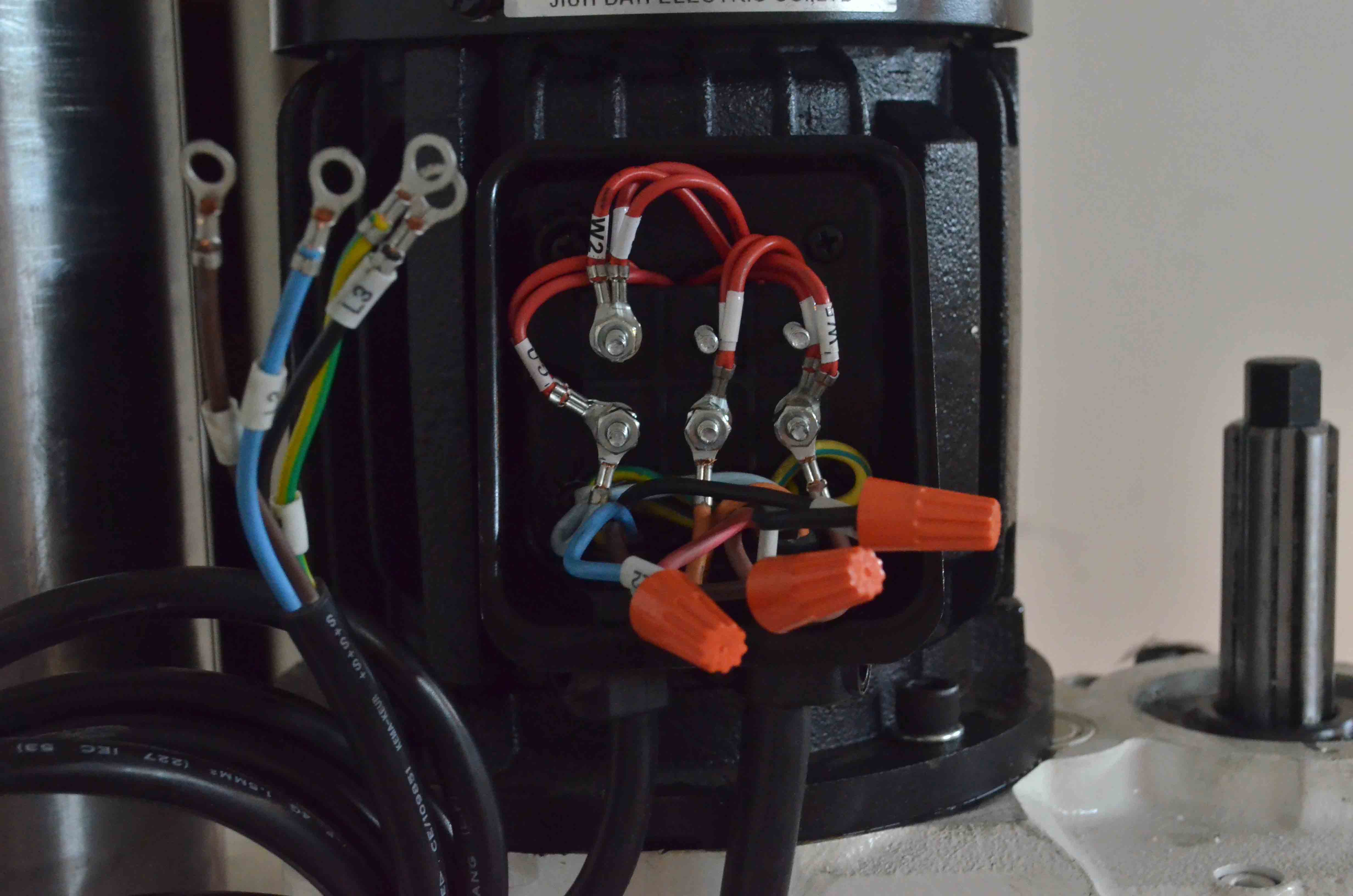

i have a machine (chinease) , the motor of it is is labeled 3phase 1HP 220v 60hz ,4pole , 3.8A
the wires coming out of it are 4 wires L1,L2,L3 and PE(yello-green) , i found an exact motor but with higher power at ebay : **broken link removed**
the measured electricity in my shop is 380 from phase to phase and 220 from phase to neutral or earth at 50hz
does the motor run directly or on this . or do it need a different 3phase ( 220v from phase to phase ). is this same naming ? or should i buy a transformer from 380v 3ph to 220v 3ph ??!! i am totally lost and a newbie to this kind of staff.
please help

thank u very much , i want to use my motor on my 3phase 380v , which as i understand from u is not the same as the motor.

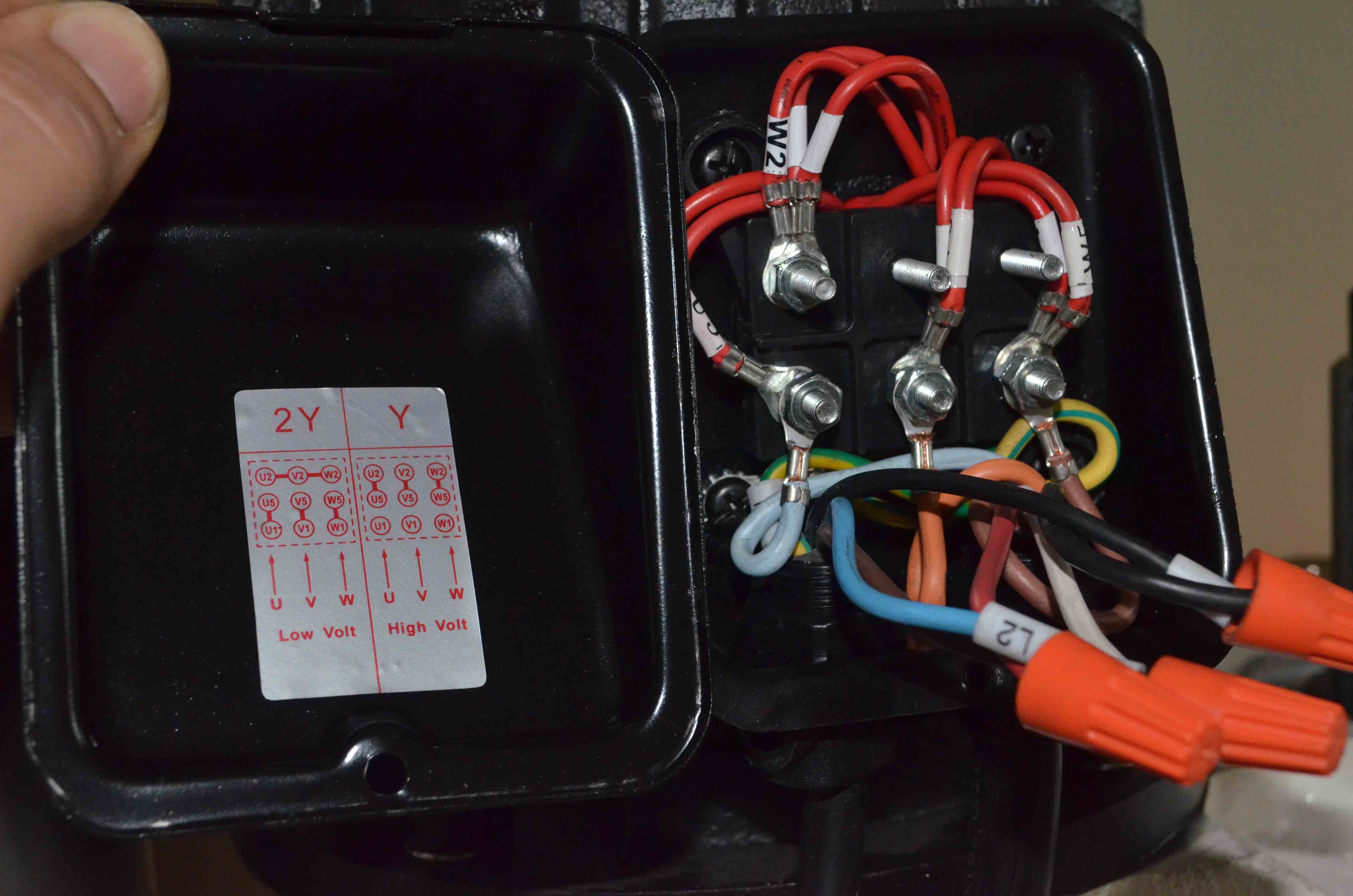

now what you said makes sense because the motor electrical box says : " Prewired 220v " and after opening that box , there are 2 ways of wiring drawn , one of them that is used (after checking by multimeter) called : "2Y and low volt" the second is called "Y and High voltage" . so simply i should change the wiring to the second called Y , please check figures and pics attached and correct me if i am wrong ??

In the photo of your motor, you have a label. Wire it as indicated for "high voltage" and it will work.
The diagram you found online is similar, but has different wire nomenclature...disregard it, it may confuse you.
But indeed, it shows how you can wire a motor in delta or wye for 220v or 380v respectively.

thank u i rewired as the specified diagram and it works flawlessly (hopefully) , i can tolerate the decrease in speed
