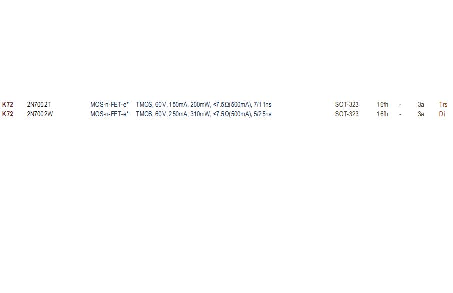

I need to replace a transistor on my laptop motherboard that I carelessly knocked off while carrying out a another repair.
The marking on the top of it is 'K72'.
I've done some research, and I think it is an 2N7002W transistor.
The datasheet I've found is here;
Can anyone help to confirm that this is the correct one? I'm not sure how to identify the package, but when I look at other SOT-23 transistors, they have different markings. So I'm pretty sure this is the right one and is SOT-323.
I was going to buy them from here;
https://uk.rs-online.com/web/p/mosfet/7082399/
Agree !
From Digikey the following link
I found following matches:
2N7002DW SOT-363 K72
2N7002T SOT-523 K72
2N7002W SOT-323 K72
It is always the same device (2N7002), in three different packages.
As you have identified your device in a SOT-323 from outer
dimensions, then you can be pretty sure to buy the right one.
Well, I've not actually measured the dimensions. I just searched for K72 transistor, and found the data sheet. It is a smd on a motherboard, and is pretty small. So I think it would be the sot-323 package, but I better go double check it now.
smd code book
72 2N7002 Sil M SOT23 n-ch mosfet 60V 170mA
if you are sure it is a transistor, use a standard n-channel MOSFET and wires. For example IRF 840
I'm not sure that is a MOSFET, as this page is a schottky diode, may appear that looks like a transistor
http://www.marsport.org.uk/smd/mainframe.htm
( Click 7 and read : "72 RB161M-20 Roh I PMDU schottky diode 1A 25V "
