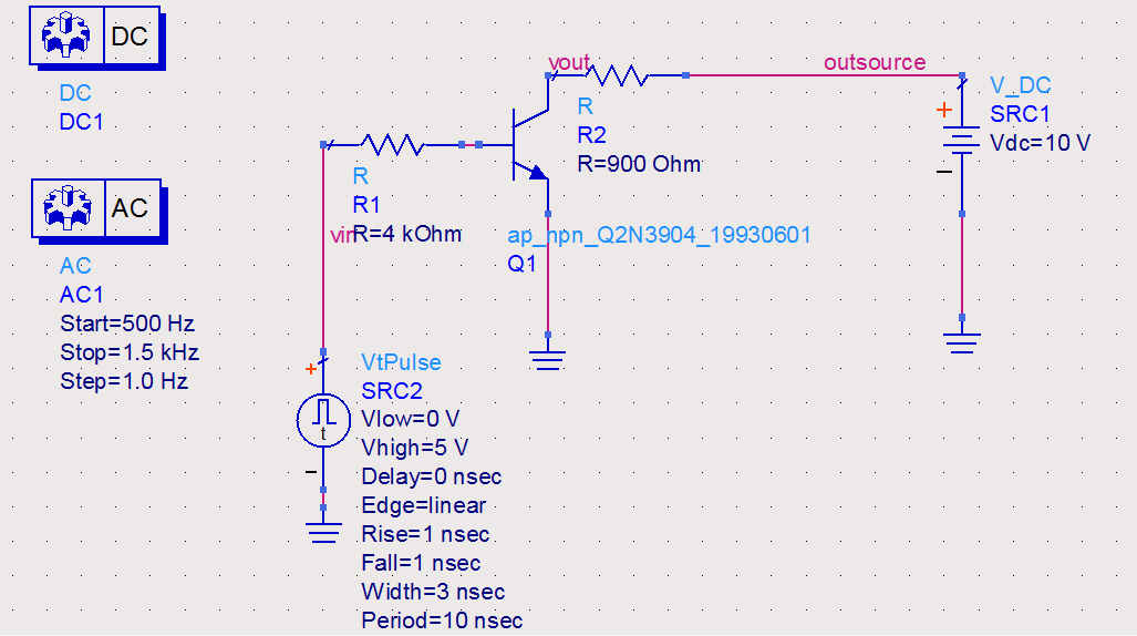

Can you tell me what frequency of input would be fine?I am using 2N3904.
This is not a question of what transistor you use.
It is the qustion what you want to switch. It is your application. We don´t know.
Klaus
I understand everything except the part where he assumes hfe.What does assuming hfe means?
Generally BJT's Ib requires 10% of collector current for best saturation and fastest speed.
Since linear current gain hFE varies widely and drops rapidly to about 10% of max when saturated, it depends on the device characteristics for Vce(sat) used vs Ic/Ib.
MAx Frequency - Transition 250MHz assumes unity gain emitter follower.
But used as an inverting switch, you depend on Ic/Ib ratio gain for saturation thus bandwidth is reduce by this value and is affected by Vce and drive current. But ideally you can switch 25 MHz give or take depending on load and Vce.
Complementary output stages yield much higher switching rates in both BJT's and FET's. (CMOS)
hfe is AC current gain and hFE is DC current gain only when a transistor is linear with plenty of collector to emitter voltage and is not a saturated switch.
The datasheet for a 2N3904 shows an hFE from 100 to 300 when its collector current is around 10mA and its collector to emitter voltage is 1V or more. A graph shows its hfe is the same for low frequencies then it drops above 1MHz so that at 6MHz it has no current gain.
The datasheet shows that for it to switch DC on and off its base current must be 1/10th its collector current so the gain is assumed to be only 10 times.
