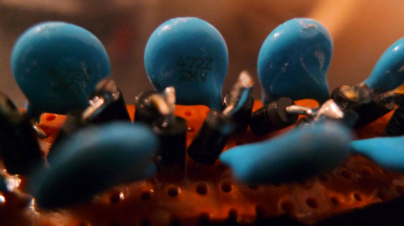

Here is a lower-voltage ladder multiplier (built a long time ago, for a peaceful purpose!), you can see they are 2kV capacitors (4.7nF) and 1N4007 I think..
At this kind of spacing, expect it to arc unless you coat it in plastic (some product called "conformal coating" as far as I can
remember). It is a transparent coating, so hard to see, but the components and board are heavily coated in it.
Bear in mind that even a small (few nF) capacitor rated at 15kV or more will be about 15-20mm diameter and
1cm thick..

You could use perfboard (as Sky_123 has) but fibreglass PCB would be better. It would be easy to make, even using rub-on transfers (like us oldies used to use) due to the large spacing and wide tracks.
When soldering, the idea is to make sure that no component lead ends show through the solder. These have sharp edges when cut and will cause corona loss: charge concentrates at a sharp points, causing electrons to jump on or off depending on polarity - this is how an ioniser works. So do 'poor' soldering, making sure to have a nice, round, shiny 'blob' of solder covering the ends. That's also why you must cut the lead before soldering, of course. Avoid sharp bends in the leads themselves, for the same (if not as critical - it's not as sharp) reason.
