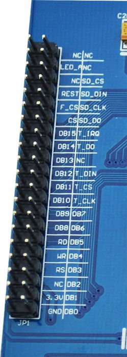

Thanks, the point where im stuck, is which pin acts as SPI interface in serial mode, TFT interface do not have serial interface, it has only 16bit Parallel interface, i believe some of data pins act as SPI interface in serial mode. Please refer to attached image of my TFT pins. Thanks. (there are also pins for Touch Panel and SD Card interface please ignore them)
