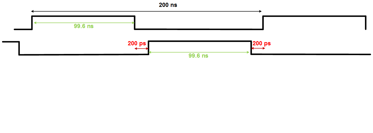

Tnx for all the comments. The attached is an example of what I want.
There are a couple of things I need to describe:
I need to have non-overlapping clocks and dead zone, or duty cycle do not matter that much to me. What I have noticed in my simulations was that any mismatch between pulse width of two non overlapping clocks will introduce distortion in my system. So if 99.6 ns in the figure becomes 99.58 ns for one clock and for the other one becomes 99.62 ns, then I see distortions.
I really do not care if that 99.6 ns pulse width becomes 99.4 ns, as long as both clocks have the same pulse width. rise time and fall time also are not important factors to me.
I am looking for a circuit I can implement in CMOS technology to give me the same pulse width for the both non overlapping clocks. I appreciate if anyone can give me a hint how to implement that.
Attached is the power spectrum of the system, it is a converter and as you can see there is a distortion at Fs - Fin, close to 47.5 MHz that is merely due to the asymmetric non overlapping clocks I mentioned before.
