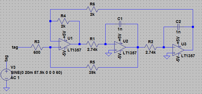

Coolrob - which of the variuous state-variable topologies are you using?
Filter adjustment: my experience shows that analog tuning brings higher sensitivity in case of low external noise. That's why I'am asking about digital potentiometers and they impact on this circuit.
I use this topology:

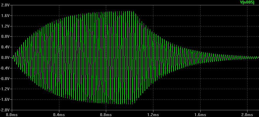

The chart below shows the filter response for 1ms 58kHz 20mV signal:
I have tried with DABP filter as per KlausST suggestion - I had to put another one opamp to achieve the same gain and the response is very similar.
I forgot about one important thing: duration of the input signal is about 1ms. So the settling time of the overall analog path is very important. Unfortunately the higher Q the longer settling time. How to play with it?
