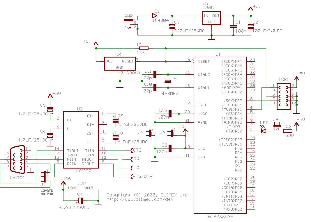

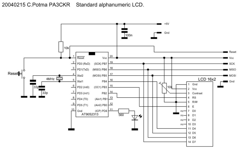

Hii how about using AVR atmega 8535 and bascom avr, it has 8 port ADC 10 bit and 1 Uart for communicate with PC. I think AVR is more cheaper than PIC in my country (LOVE INDONESIA).
For AVR atmega 8535 u can use this schematic and modified it
but u must know that using internal ADC AVR u must use inductor, refer to datasheer AVR ATMEGA 8535 for further explanation.
for LCD u can use this :
it's used at90s2313 u can modified the port for atmega 8535, see the data sheet
and for communicate with PC u can use max 232 for level converters :
just modified for atmega 8535, see the datasheet
