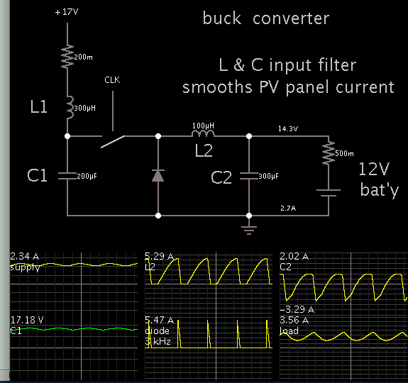

Hello,
I'm studing a System for an array of solar panels (240W each, 16 in series).
I'm considering using a buck converter to charge a high voltage battery pack (from 300V to 380V when full) from the pannels.
the circuit i'm considering is attached.
During the simulation of the circuit, when i use an ideal voltage source as Vi for the buck converter, I obtained a pulsed current (as the attached image )
When i placed a solar panel as Power source for the buck converter, the Input current was completly diferent. It was constant ( attached the image ).
Can anyone help me understand the wave forms and which one corresponds to the correct wave forms in a system like this ?
Thank you.

It helps to add an input filter at the front of your converter, so that you draw current smoothly and continually from the PV panel.
Looking at your schematic, it seems as though you have a smoothing capacitor at the input. Perhaps this performs some degree of smoothing? An inductor can provide further smoothing.

Thank you for your answer.
Considering the functioning of a buck converter ( draws current from the panels while the switch is closed, dont draw current from the panel when it is open ) the power from the pannels is pulsed. In that situation can be complicated to find the power output from the panels to find if it is already on the maximum power point or not.
Because of that i did simulated the circuit with both a power source and a panel. The panel provided a constante output current even when it is not supling the load.
In a real aplication it would work like that ? the current would be constant or it would be pulsed ?
The purpose of this aplication is to charge the batteries with the maximum power suplied by the panel.
If the power from the panel is pulsed it can be hard to find if i am operating in the maximum power or not.
Am i right thinking this way?

This illustrates the LC filter which smooths the current waveform from a PV panel.
Notice the PV panel supplies constant 2.34 A. However see the waveforms going through the buck converter, peaking over 5A.
Perhaps your simulator's PV panel contains a similar LC filter? A simulator model of a PV panel is likely to be unusual. It certainly does not behave like an ideal voltage source. Occasional a poster asks how we might model a PV panel, but an easy method is not evident.

it probably has to do with the simulator which has as you state an "ideal" voltage source which implies that for any current drawn there will be no voltage drop. This would not be the case for a PV panel as when current is drawn the voltage drops and the feedback circuit will take this into account and not pulse. Well that is what happens in my circuits in real life and simulation. "Ideal" sources have no internal resistance.
The voltage pulses are changing after the 4th decimal point but the power and current fluctuates between the zero and max. Very strange.
Something similar to motorboating. You need to play with the simulation parameters, perhaps. Is the pulse frequency is related with the RC time constant? Acting like a relaxation oscillator?
You just need to fit a very large high voltage electrolytic capacitor across your PV panel array. That will hold a considerable charge, and smooth the pulsing current drawn by the buck regulator.
The PV panels then supply an almost constant charging current into the electrolytic.
The buck regulator is then able to source a much higher peak current at a (sometimes) very short duty cycle.
