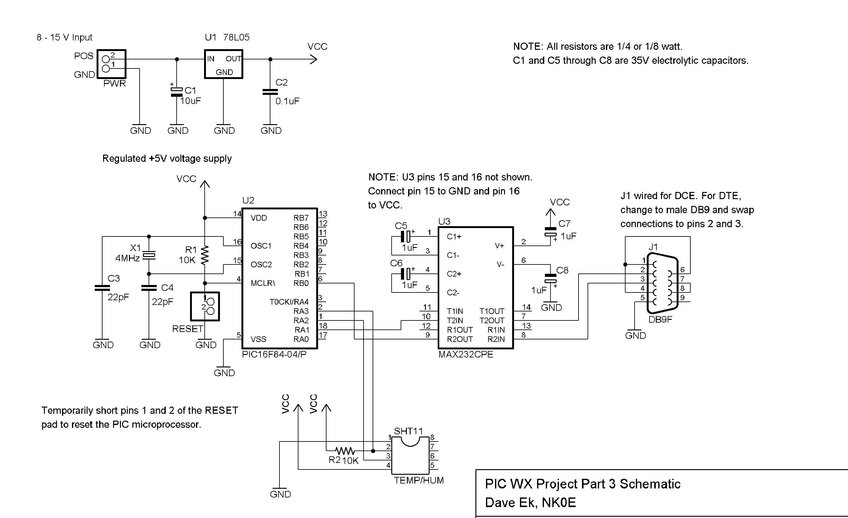

I'd like to receive a circuit diagram for interface PIC16F84, 16F628 or PIC16F877(microcontroller) with SHT11 and code CCS-PIC. Display can be LCD or PC [Input Serial/Paralell Port].
I need routines for reading the SHT11 sensor (humidity and temperature) with a PIC microcontroller - LCD.
Please, send me the details of how to connect the PIC to SHT11 and LCD.
Can anybody help me ?

use this link and select topic
2004-03-10 23:24:48 Update Neue Downloads unter Projects (PIC Mikrocontroller)
